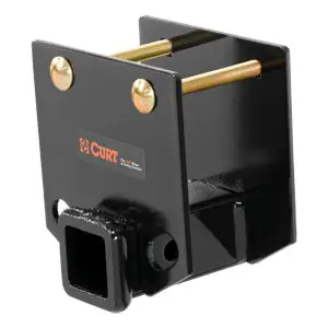

A couple weeks back, I was checking out a guy's full-time BF camper (kiteboarder). He has a triple receiver hitch (I've seen those before as I suspect many of you have as well) and he used the outer receivers to mount/support, a full-width under box at the rear of his camper. Great design (custom box with a step). It did get me thinking again about an accessible spare tire mount. I have a SuperHitch magnum (30K) hitch. The cross tube is 4x4 (same o/s dimension as many RV bumpers). Curt makes a bolt-on RV bumper hitch (you've likely seen them) for 4x4 bumpers. The light flickered and me thinks I'll grab two of those RV bumper hitches and bolt them to my SuperHitch. That way I could make a simple spare tire mount for the rear of the rig (couldn't buy the usual hitch mounted spare rack as I have too much overhang). I could, in fact, do a pair of them and bridge them with expanded metal stair tread for the nice step/landing. Even if I didn't add spares to the rear (I have two extra spares, one Alcoa front and one inner/outer steely, so seems I should), the The RV hitch mounts would allow me to build the deck/landing/step regardless. I think the smart play would be to make the deck supports (which would be 2x2) with receiver ends so I can choose to use spare mounts, or one mount or remove them when not needed. I may have to beef up the RV hitch mounts as they are only rated for 3500/350 (if I recall). The deck extension, although shared, would definitely lower the rating. Expanded stair tread would actually go below the current hitch extensions.
rOg1yO3CULDuLPgSOgJZW89e_1VHUmgvSpFTcUljmRPkOmDD8DcaI5EP-O2AxlaDSbpOjfvAQNqH_Q=w1920-h1080-no
I have two different hitch extensions (this is the shorter one (cut down and reconfigured in order to increase capacity)). So long as I keep the tread under the extension, I could run either without an issue.
R-5Gh_Imlrx-6Gtxh_RXJOhq8J7NTP656o9FYWiU93y_7wNesP99HzQ_nwAHIlDnfis4kvu3OUzOow=w1920-h1080-no
The Bolt -on Curt RV hitch:
The Galv stair tread I have (more or less).
Anyway, I think I have a plan.
