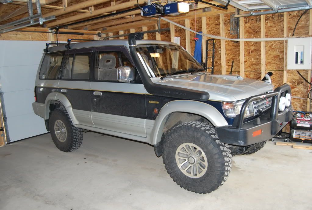

Snorkel on, and tires installed: 33x10.50 KM2s
Thought it was time for an update. Finally got my snorkel on, and tires installed. After deliberating for way longer than necessary, I decided to go with the KM2s, in a 33x1050-15. One of the secrets of the Montero/Pajero is its ability to run 33" tires at stock height. I gave mine a slight lift (as referenced above), and still have plenty of room.
This truck has 4.90 r&p gears, so the larger diameter dropped my revs a bit on the highway (which is good for the diesel) but really had no other adverse affects.
Snorkel is a genuine ARB-Safari snorkel. Nice to have it on the rhs, so I can turn the head backwards as I approach a dusty road... :sombrero:
Here are some pics (sorry for the garage pics, but I just got em on this week, and haven't had a chance to take them "out" yet, except back and forth to work)

Looks good Phil, is that what you would call pizza cutters? If so that's my next size.
Thanks Michael. Yes indeed, these are my skinnies, but I call em "pizza mudders". :sombrero: So far I've run em in the rain, on the superslab, and on gravel. They really do run like an AT on the road. So far so good...
