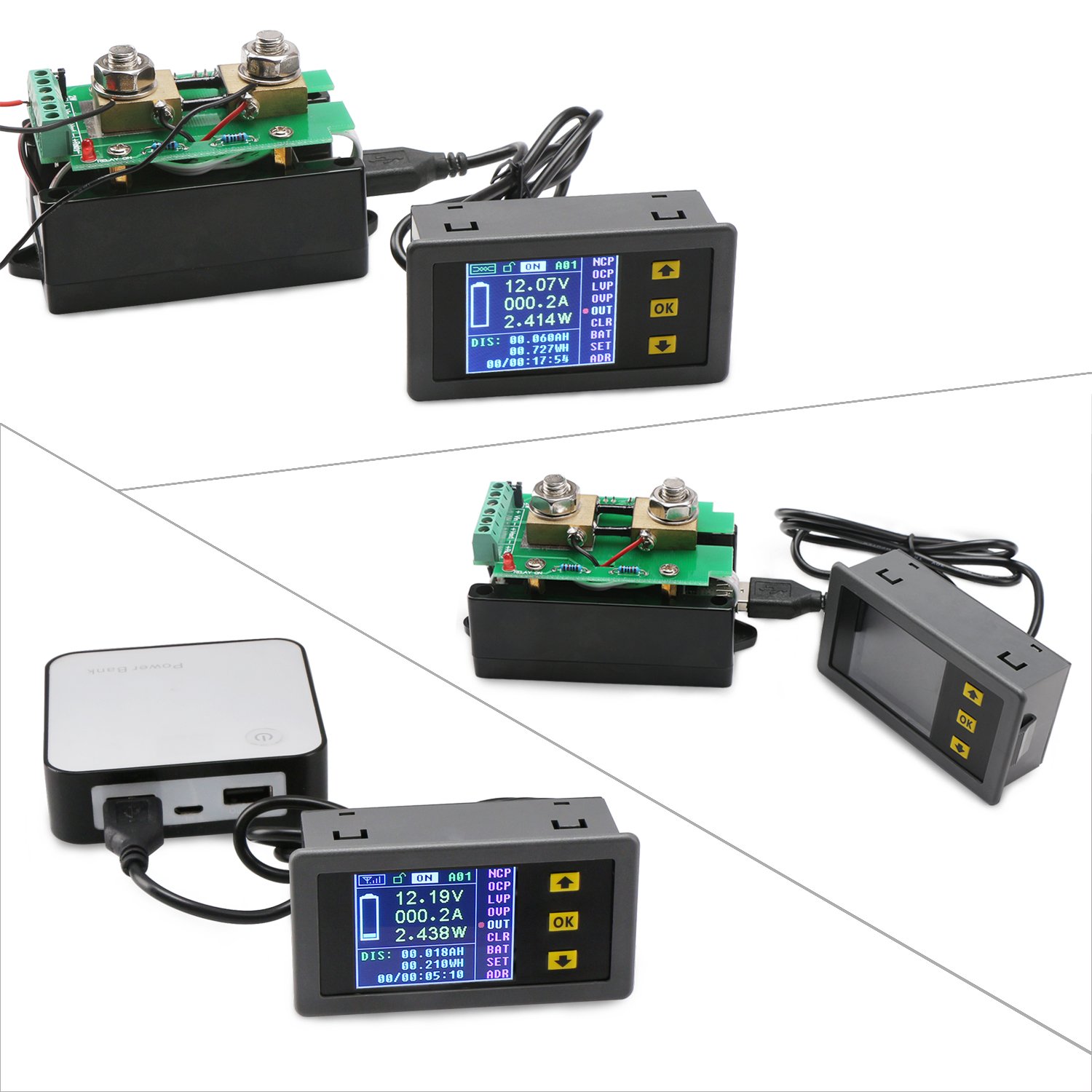

The Solar brand battery tester seems to be limited to telling you what the cranking amps are? I briefly looked at the manual and it was not very helpful. The tester that I have reads out voltage, internal resistance and calculates CCA. I think the ideal situation is to install an inline meter to measure battery amp-hours going in and out. I've only recently started looking but this is one example
https://www.amazon.com/DROK-Multime...qid=1494432893&sr=8-1&keywords=amp+hour+meter
