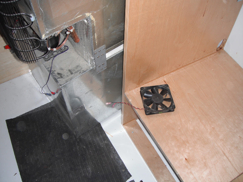

Took the fridge out again! I need to move the fan to the opposite side so that it will be in the bathroom area and should be quieter ,it's been a couple of feet from my head so anything will be an improvement, not that its loud.

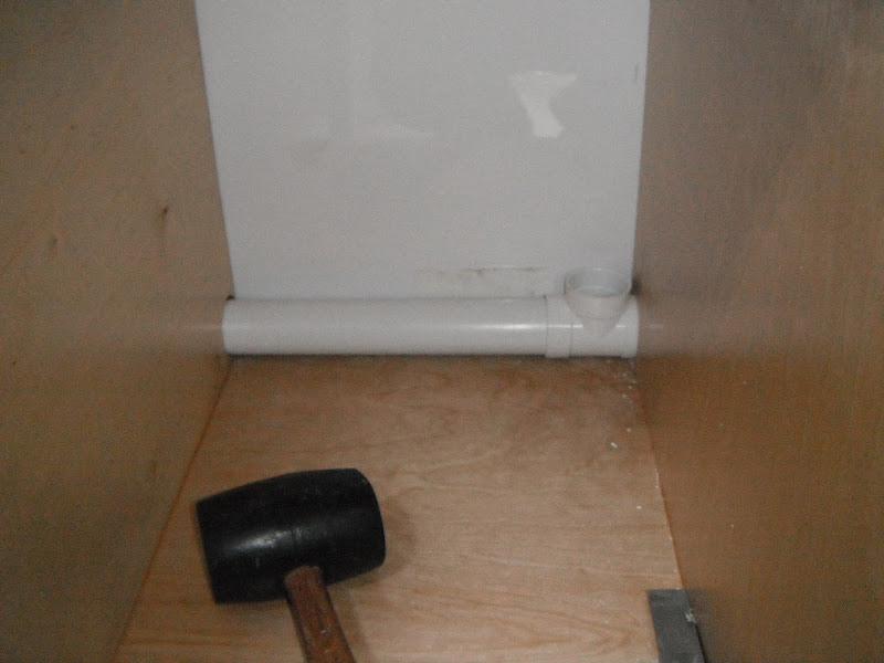

Installed the conduit that will have the water and electrics run's through the fridge unit and re-installed the fridge.
Feels good to get some noticeable progress!
