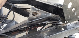

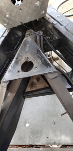

For those interested in what a 17' Casita can be safely made to carry its; 4 MTB's and a TW200. The tongue weight with a half fresh H2O tank is 725#'s and almost 4K# on the axle hooked up and loaded w/a WDH on a CAT scale.
The extended tongue and 5200# axle on 4200# leafs w/shocks handles it all quite 20210901_124316_resized_2.jpg20210901_124335_resized.jpgwell.
