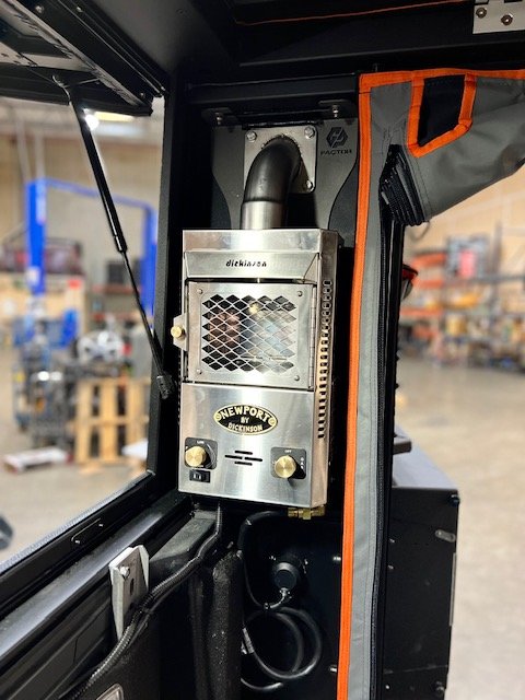

I used alu Rivnuts in several places too, mostly for heavier things like the wood panel and electric switch box combo, my Wave 3 heater and some 8020 add-on. Works great, but a bit of a PITA and overkill IMO for light stuff.

I kinda think these wont help you too much, but here you go …
This is the rear corner by the doors. Couldn’t even get the small Rivnut tool in there so used a self tapping screw.
My heater mounts. All the Rivnuts have been centered in the frame members. I had to use spacers here to clearance the heater mount.
