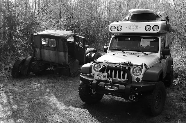

Until then, here are a few images from the trip...

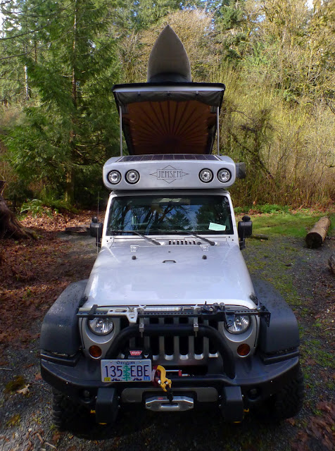

(above) Freeway on-ramp...Welcome to Washington....(color picture)...

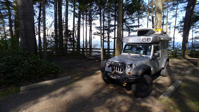

The basics...I'm road testing The Jeep I've been working on for months...The road plan is to circumnavigate the Olympic Peninsula...I have no schedule other than be back home in four or five days...
My first impressions of driving The Jeep...It's smaller on the inside than it seems...Up front at least...But once you settle into the size, it feels as custom as a set of dentures....No space up front seems wasted, but it doesn't feel crowded...
It's heavy...Unlike my daily driver, a 2006 Sprinter, this thing has mass...Combine that with the off-road capable suspension and wheels, it feels unlike a race a car...
With those observations out of the way, onward...

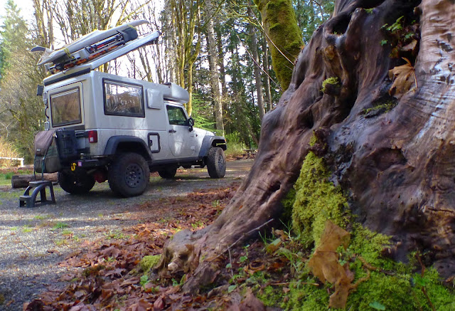

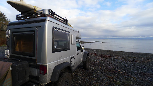

(above) First stop...Southern Hood Canal...
(above) Potlatch S.P.
(above) Last week this place accepted six inches of rain...That might have been in a day...???...

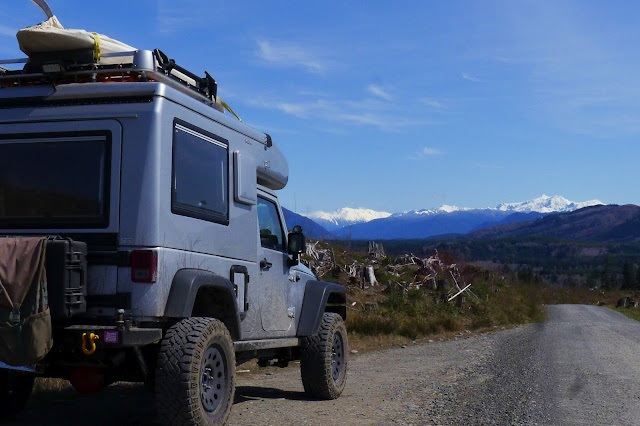

(above) North...
(above) Land O'trees...

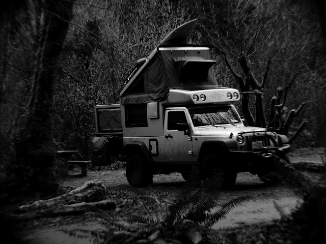

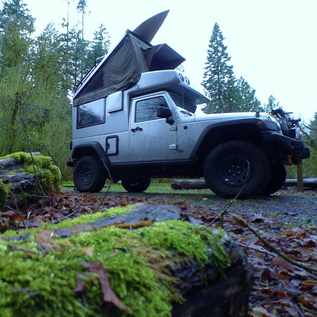

(above) To get it open is like this...Before you turn off the motor, the switch for the compressor is to be turned on...Let it run, get out, open up the back, get in, find the switch for the pneumatic rams to mechanically lift the roof...Push switch up, observe the roof lift...Stop before fully raised...Release the tent from the roof...The engine is still running...Wrap the front tent part outside of the rams and zip the front to back tent parts...Push roof lift switch to fully raise the roof...Insert the plywood boards that are the emergency roof stops...(You never know)...Finish attaching the tent to the lower cabin...Velcro and Snaps...Open up the front tent window and insert twin plastic eyebrow window supports...Velcro the trap and you're done...elapsed time about ten minutes...
(above) Inside for the night...After dinner (a store bought sandwich)...Going through the pictures...
(above) Next morning after putting the sleep stuff away and rolling up the tent...To bring the roof down, you reverse the set-up...Duh...
