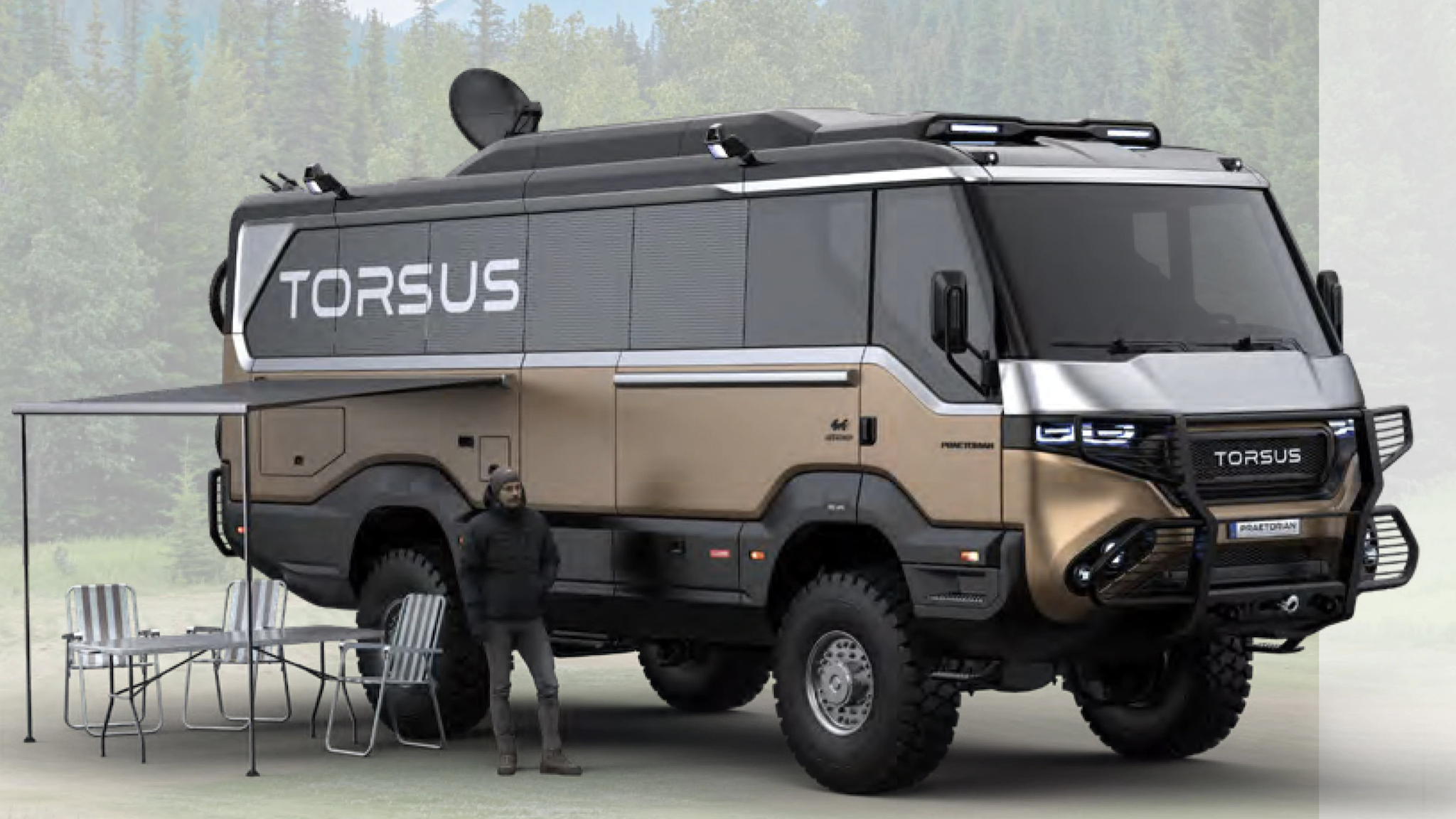

Looks like you want one of these:
https://www.automobilemag.com/news/torus-praetorian-overlander-4x4-bus-info-photos/
