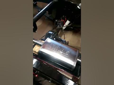

I'm going to be installing a stainless steel straight-through exhaust. Here's a little preview. The exhaust will be welded after putting the bodywork on the frame.
Pipe thickness 2".
