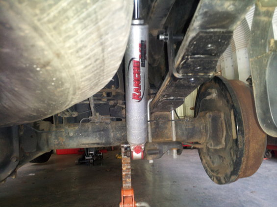

Xterra H233B is sprung under so I will have to cut/remount perches on top of the axle. Will cut and remove the sway bar mounts at the same time.
Plan is also to "flip" leaf spring plates to top side (factory positions them underneath the axle) also will weld new shock mounts on the axle housing itself.
Will gain some clearance with this set up.

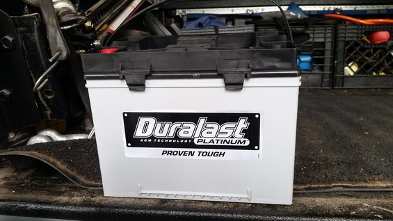

Decided I would feel better if I went ahead and sprung for a new battery before the trip. A good friend has been trying to talk me into trying a Duralast Platinum. It appears these are a rebadged Odyssey battery. I have never owned an Odyssey but have heard very good things about them. Autozone sells these for a signifigant savings over the Odyssey. Figured I'd give i a try.

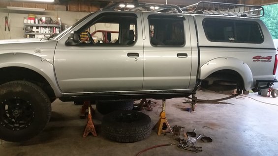

Differentials are built and installed . I did install at friends house and was not able to get many pictures.
Under the knife...

Will get detail pictures soon. i am super pleased with extra clearance gained by the u-bolt "flip" on the rear axle.

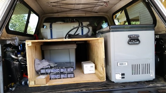

Build a super crude box to hold some totes in place. Crappy picture doesn't show totes , but you get the idea.
Put a few ports in line with the vent on the fridge to make sure it still breathes well.
Mounted a 12v spot sprayer to the top of the box for a water supply.
