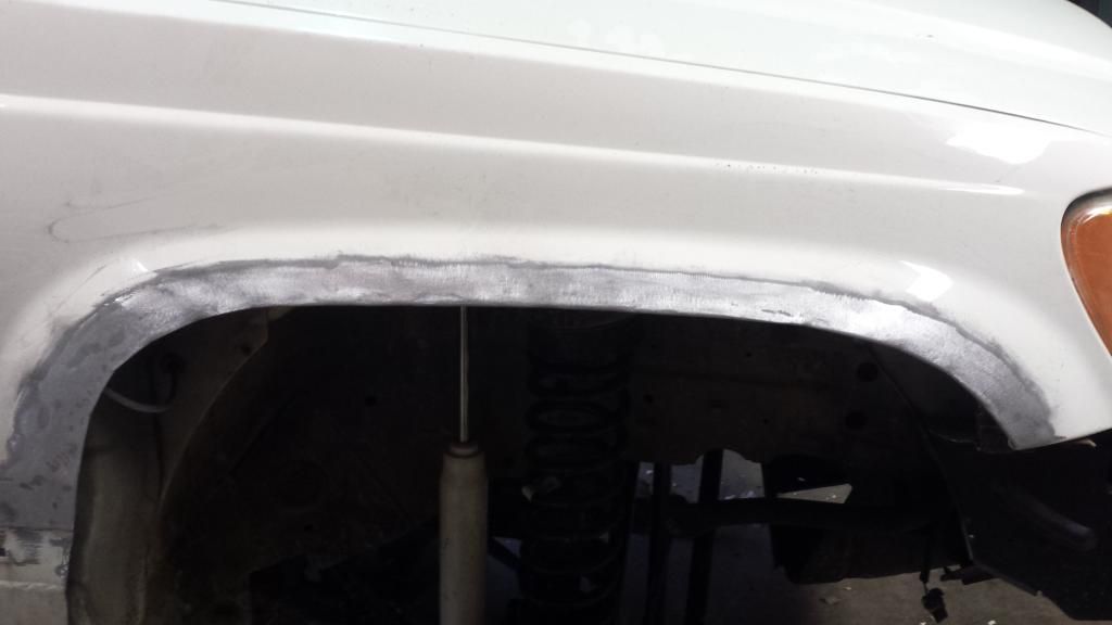

A little trimming on the front
Was able to get a little more done this weekend. The weather did not help at all. Garage never got above freezing, so bondo and seam sealer weren't working and will have to wait until it warms up. I did get to run around in the snow and have a little fun though.
Here's how the rear tire sits now with all that room !!!!
Here's how the fronts started ..
Here's the metal we cut out of the front ..... I was a bit worried cutting that out, but after inspecting it (a few times) ..... It didn't seem to be needed after trimming.
I applied a light coat of primer after this as we couldn't get the bondo to blend. I'm not showing a picture of it, because it looks like crap and I really want to finish on the first warm weekend we have.
