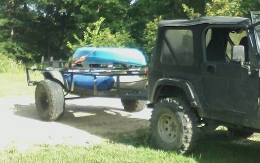

MOguy
Removable, here is mine:

Re-moveable and height adjustable for Annex use, no need to compromise. My build in sig..

Dstock, can you or anyone else help me with design pics and welding material specs for this rack. The local welder has never done anything like this before and is a bit confused. Need helpas far as channel, tubing, pull pins, etc. Should the rack be built the full length of the trailer? What about the annex and interference with the fenders? What size channel or tubing is strong enough, the tent weight about 120, just build legs on each corner of trailer? As you can see lots of questions from me as well, its all new to me! Thanks for everyone's input and information!
