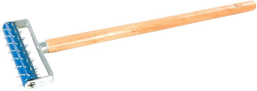

If you use XPS, I'd recommend a wallpaper perforator to texture the surface. Really work the glue it, then add more and trowel it.

Is the PVC foam core XPS as well, or am I confused about terms?
No, totally different. The reason for texturing like that is because the XPS is very tiny cells and weak, and glues don't stick to it well. So, increase the surface area and also give it more of a 3D surface. It should be rough sanded first as well. The PVC is much stronger and large cells so when it's cut it's already rough, and adhesives stick to it much better.
XPS is cheaper... that's the only good reason to use it.
PVC is polyvinyl chloride. XPS is extruded polystyrene.
