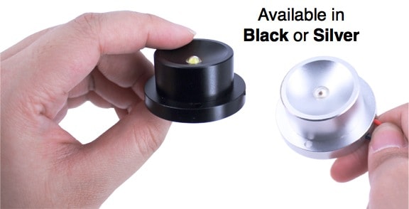

I've been looking for a good "puck" LED mount to put in my exterior floods. Looks like these are a better product for a good price. Would you go with their "cool" or "natural" for that?
Ha, we're thinking along the same lines.
I considered those also, but I'm pretty sure your walls are only 2" thick ID like mine and these are about 3.5" long overall. So, depending on how you mounted them the fan would be jammed up against the interior wall, if it even fit at all. Remember, the reflectors are already recessed. Plus, they are not waterproof and require a separate inline LED Driver. Besides, for camping you really only need a flood range of about 50' or so to light up the campsite area around the vehicle.
I've been looking hard at these High-Intensity LED Flood Lights from Oznium.com.
They are fairly inexpensive ($18.00 ea. for three or more), completely waterproof, compact, easy to mount, and have a 120* Flood Angle. They are available in six colors: warm white (3300K), white (6500K), red, green, blue, or amber. The warm white is 78.3 lm and the cool white is 70.4 lm which doesn't sound like much to me, but the reviews say they are 'insanely bright'. The average weapon mounted tactical light is around 230 lm and the ones I have will fry your eyeballs.
I prefer the 'natural white' or 'cool white' over the 'warm white', which always has a yellowish tint to it that I hate. Anything in the 5,000K to 6,000K range works for me. However, the Oznium rep states, "The Warm White (3300K) has more *visible* light output than the White (6500K)...". Too much of a blue tint gives everything a 'ghostly' appearance to me.
I guess the only way to really tell is to order one and play with it to see.
