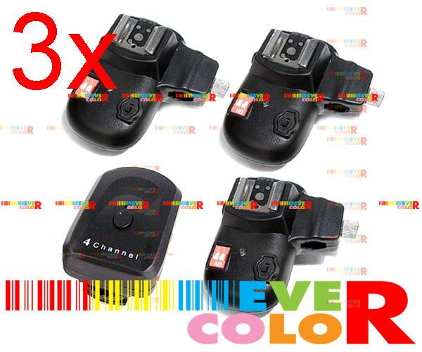

I did this for a while and then I decided to take a chance on what is known as e-bay triggers. They are Chinese made transmitters and receivers which are both loved and hated on photo forums.
I went with a set that had one transmitter and four receivers. The receivers even have umbrella holders and my total cost was $63.00. Since I already had two Pocket Wizard Transceivers I figured even if they were crap it was worth a shot to try these out. This was one of my best purchases ever. These things have a range equal to the Pocket Wizards, are about 1/4th the size, and they will even fire a flash on the other side of a wall. I use these for all of my location shoots and only use the Pocket Wizards with my studio strobes. Another benefit for me to use these was I already had two Olympus flash units for my DSLR's and I had two older flashes from my Canon film cameras. I was immediately able to set up four flashes for a shoot and fire them without several cords tying everything together. I have to set all the flashed manually but I don't mind doing that at all.
E-bay triggers
