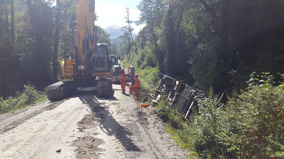

I saw this on another site, the couple pulled over onto the side of the road to let other vehicles pass, and then the ground gave way beneath them.
It is one of our fears as well, I know how soft the shoulders on roads are, they are seldom compacted and act as a drain, add to water and you just have mud. Just putting your wheel off the compacted surface and you could end up like this.
They are both OK, minor bruises and I hope they are able to get their truck up and running again. It is a MB 1017. Not sure if they were on this forum, but I recognise the truck.

This give a better view of the angle.
The road was narrow, and they pulled over to let other cars past. YOu can see the tyre track on the right of how far off the compacted surface they were.

It's a mistake can easily imagine making myself. From the photos there is nothing to indicate how soft the verge must have been.

Unfortunately, this was a rookie mistake (I mean no I'll will) probably exacerbated by someone tailgating and the emotional pressure to get out of the way. That rig is heavy! Pulling over simply to let someone with a bee in their pants go by when the shoulder looks even questionable is simply wrong. This looks like a combination of errors that cascaded into a bad end result that should be a lesson for all, particularly big, top heavy, overlanders. Again, glad to hear all were okay.

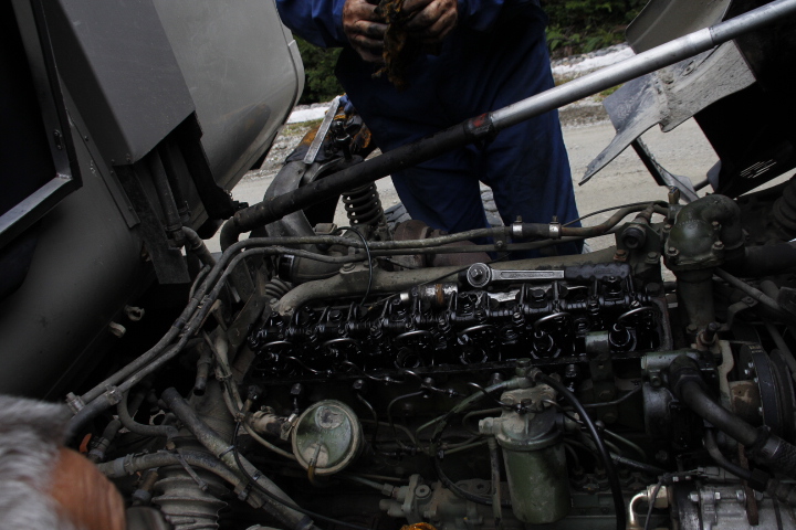

Good new is that they are back on the road again -
They also realised that leaving the truck upside down would be a problem, so they pulled the injectors and turned it over to get the oil out.
Overall, not that much damage.
