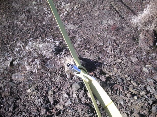

What JIMBO said. Shortening the length of a strap is easy, quick, and relatively secure. You can use a hitch pin, a stick, even a bunch of dry grass. I've done it many times, teach it, and it works great.
You can also attach two straps together using a similar approach.
