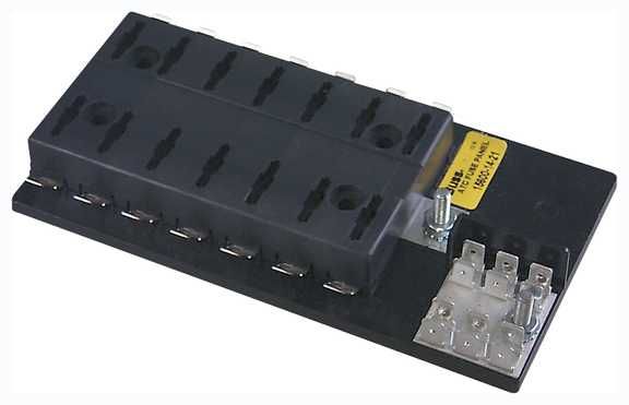

That fuse block does not have a bus bar.
To explain what I mean, here's a fuse block with a bus bar:
In the pic above, the hot comes in to the screw on the top in the middle. That is the end of the bus bar. The bus bar runs down the middle. Each fuse, has one end connected to the bus bar.
So the power comes in, runs through the bus bar, through the fuses, and out the 6 terminals.
The fuse block pictured on the trailer doesn't work that way. It has no bus bar. Each fuse slot, is separate.
You have to run 7 hot wires in, to feed the 7 fuses, and then 7 wires out, to feed the circuits. Or, on the bottom, where the hot comes in, you need to jump from the hot on the first screw, to the next screw, to the next, to the next, to feed the 7 fuses, and then you use 7 wires out the top to feed circuits.
By connecting the hot to the bottom of Slot 1, and the negative to the top of Slot 1 - you have just created a dead short waiting to happen. As soon as you stick the fuse in, iit's going to burn. You have literally wired the + and the - to each other.
No negatives should be connected to that fuse block. 7 hots in to feed the 7 fuses, and 7 hots out of the fuses.
The negatives have to all be tied together somewhere else.
Some fuse blocks have the hot bus bar, AND a separate place to tie all the negatives together:
The fuse block in this pic has a bus bar for the hot - the incoming hot wire from the battery goes to the big central screw on the left. That feeds the fuses, which feed the loads.
Then it also has a negative bus bar. The negative from the battery connects to the big central screw on the right, and all the negatives from the loads go into those screws on the right end of the fuse block.
