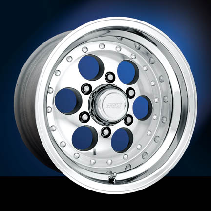

I am able to get a really good deal on these wheels: 77414d1373079080-fs-5-trail-edition-wheels-17x7-5-image.jpg. They are the "Trail Edition" wheels from an FJ Cruiser/4runner (year 2011+). I think that these will fit my Monty, but I wanted to know if someone out there can tell me if that's correct. They have the same lug pattern and bore, but I think the offset is different?

Center bore (where the hub goes) must be at least 108mm. You can usually tell just by looking because the center hole goes right up to and in some cases past the mounting surfaces of each of the 6 lug bolts.
As for the offset, I can't say for sure. I can tell you that my old 15x8" wheels (American Eagle Type 054) with a -17mm offset, 3.75" of backspacing running either a 35x12.5 tire fits fine on my 96SR with a 2" body lift and the torsion bars slightly cranked... although there is a very slight bit of rubbing on the inner fender liner. The bumpers off course are totally aftermarket as it would rub severely on them.
For my 33x12.5's AT's I'm running 15x8 Method Double Standard rims. They have -24mm of offset and 3.5" of backspacing. They fit fine w/out any rubbing whatsoever.

The ones I was asking about in the first post are 106mm, 2.5gen is 108mm. So they didn't work out.
Yeah, unfortunately I suspect (based on my own searches before) that among Toyota's only the FJ80 has 108mm center bore and 6x5.5 bolt pattern.
