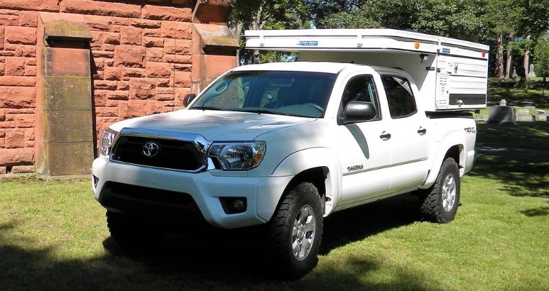

I have a 2008 Finch currently mounted to my 2015 Tacoma. I like the north south bed because my wife and I can each get into or out of bed without having to climb over one or another. We sleep with our heads towards the back of the truck with our feet forward. We sleep in two 33" x 77" Walmart sleeping bags that are zipped together to make one 66" x 77" inch bag. I think they are rated for 40 degrees or there about. Sometimes we put an extra blanket on top if it's a cold night. I usually keep the thermostat around 55 or so.
I think FWC started making the cab over section a little thicker sometime after 2008. In order to allow more room on top of the bed with the roof down (I'm not sure about this). I can not leave my sleeping bag on the bed with the roof down. Not enough room. We roll it up and strap it to the fold over bench seat when we pack up. I do have a layer of reflectix under the cab over section of the mattress which makes everything even more tight when the roof is down.
You just need to be careful not to smash your head on the roof lift bar (not sure what it's called) when you are rolling out the bedding and wiping the condensation off the walls. Also it is a little bit of a climb to get in and out of bed.
