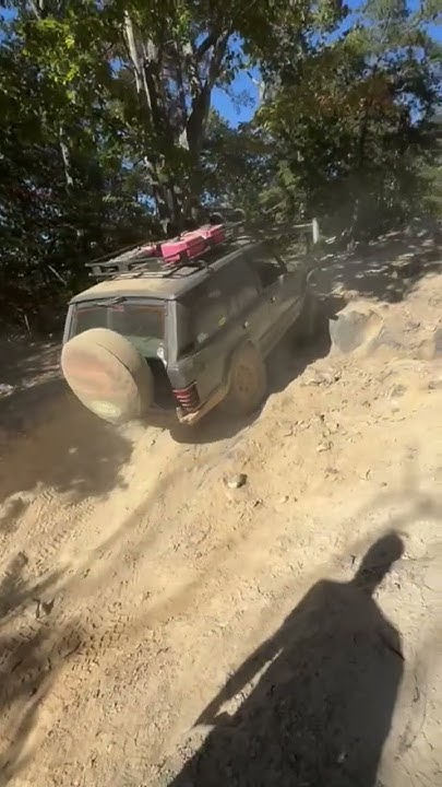

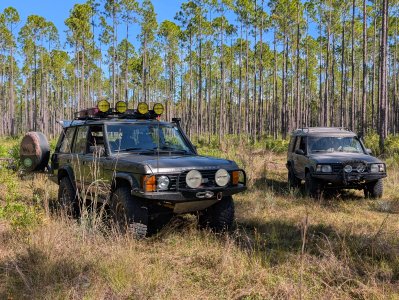

After the fan replacement I had a new AC compressor, drier, and expansion valve installed. The A/C works great, and it was fixed just in time to go to the 20th Uwharrie Rover Expedition in North Carolina. The truck did really well and made it easy for a semi-novice like me to learn to rock crawl.
