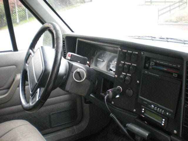

My mile marker unit:
You cant see it in this picture, but the two red buttons for control are tiny. They are behind a sliding panel on the face of the remote.
Here you can see the control box mounted on the steering column.

I've heard that Roadless has quality gear, but looking at the dash mount kit...yuck.
Crummy plastic insulated crimp on terminals, and they are spade terminals. Looks like something someone would throw together at U-haul.
Based on that, they have zero chance of getting any of my money.
I'm not sure I like the fact that it doesn't have a master kill switch on the box itself. Could you get radio interference and have the winch activate while you're away from the truck, could cause big problems.
Tom, are you looking at the right picture/reading? The roadless gear is the top photo, its not a dash mount unit. The photo below is from milemarker, and IS a dash mount unit.
The electrical connectors have been soldered on and shrinkwrapped. It doesnt get much better than that. They are not crimped on.
