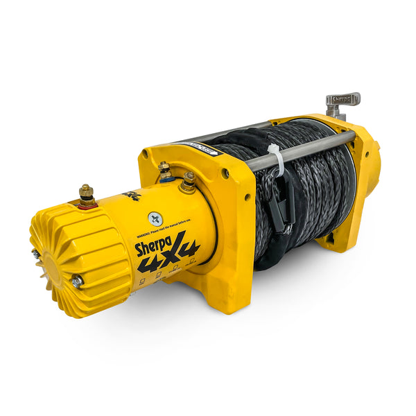

Now on to getting a couple winches ordered. Leaning towards the 17k Sherpa with with 150' of synthetic for $1600. I like the long line but the other option is a 25K winch with 100' feet for $2,000. Not stressing over the price but just can't decide if I would prefer the extra line length or the horsepower.
These are both Sherpa winches and I'm not against Warn but for the price these are hard to beat. I can buy two of these for the price of a Warn and if one broke I could always just move the other to front/rear as needed.
I think a 17k winch on a 12K rig with a good snatch block should get me out of trouble. We have an 8k Warn winch on our 10K van right now and I've definitely maxed it out more than ounce so that has me a little concerned.

An 8,000 - 10,000 pound winch is more than adequate for a large vehicle that isn't being used in difficult off road conditions. They are lighter and take up less space and you can now "afford" to buy a top-quality winch, instead of a budget winch rated at 16k - 20k. Carry UHMWPE winch rope extensions, soft shackles, tree saver straps and a RED recovery ring to replace a heavy snatch block and you will be in good shape. The maximum pulling power of a winch is only accessible on the final layer. So, if you pull out 40 feet of rope on your 16k winch, you aren't getting anywhere near that pulling power. If you need a bump over a rock or a log, this is not an issue, and a 8k winch works just fine for this. If that is not enough, you need to pull a longer line anyway. This gives you plenty of room to find a good solid anchor, have a nice straight pull and to attach one or more pulleys or snatch blocks to create 2:1 or even 4:1 leverage. Your 10k winch will now pull 20k - 40k.
I wish I would have looked into Tesla stuff more I agree that would have been a good way to go.
That’s good advice on the winch except that the max pulling power is on the first layer of the drum and they typically loose around 15% per layer.
On our current van with an 8k Warn winch trying to pull through a bumper high snow drift I’ve definitely stalled out the winch but that was with a very short amount of line out thus probably only 4K of pulling power. With a 2:1 setup it pulled right out no problem.
My thought with the budget winches is that I can get two of them for the price of one Warn. If one of the winches failed I could always swap with the other winch if needed. Assuming of course that I go with both a front and rear winch.
Agreed on the soft shackles and ditching the heavy snatch blocks. What was the brand you referenced for the soft shackles and extension lines?

Final layer meaning base or bottom layer, i.e. the more rope you pull out, the more pulling power you have.
RED is a brand of winch, made in the UK. They offer what is essentially a machined aluminum 'pulley' designed to be used with soft shackles, so the old 'snatch block' goes to the recycle bin.
For soft shackles, you want to make certain that you have one tied in a button knot, like this, not just tied in a knot and burned on the ends. You also want to ensure that the soft shackles are 'rated', appropriate for vehicle recovery and made using quality materials, not cheap knock-off crap to save a buck. Kevlar chaffing sleeves are a bonus, as UHMPE rope is basically plastic and does not have the durability of wire rope if it is used in a rocky or dirty/muddy environment. Bonus, toss them in the washer or rinse them out in the sink. Try that with your wire rope. :D
Thank you for clarifying that. My pea brain was having a hard time wrapping itself around the power per wrap question.
DzlToy
Illustrative example: Try taking a lug nut off your car or truck with a 3/8" drive socket wrench that is 6 or 8 inches long. Now try taking that same lug nut off using a 24" socket wrench or cheater bar. It's much easier, right? The opposite is also true. Hold the end of a 24" cheater bar and imagine trying to turn the socket or the lug nut with your hand. The leverage at the end of the cheater bar makes that impossible. Shorten that arm and there is less leverage at the end. Thus. smaller winch drums, i.e. fewer wraps of rope on the drum, offer more pulling power than a large diameter drum or one loaded up with lots of rope.
So, to maximise the pulling power of your winch, pull out LOTS of rope, use pulleys or snatch blocks and make long, straight pulls, not steep or angled pulls to the nearest tree because you were in a hurry or are lazy.
Back on track: What other recovery gear have you decided on other than winches? Have those winches been purchased? If not, I would encourage you to buy once/cry once instead of buying a pair of lesser winches. JMHO.
The other recover gear I have are these recovery tracks, 40k 1" kinetic recovery rope, tree saver, and a couple pulleys along with soft shackles.
I have no problem buying a WARN winch but let's not kid ourselves and think those are 100% American made. The M8 Warn winch i got for the van had made in china prominently displayed on several parts. I do believe they are assembled in the US which has far better quality control than anything overseas. I'll probably end up going with the Warn 16.5.

Add a soft shackle and a pulley and you have a 20k winch that will last a lifetime. It is rebuildable, serviceable and can even be modified by adding Albright solenoids or dual motors for increased pulling power or line speed. I am not a "fan" of Warn, per se, but I have had experience with "Powa-Masta" or "WinchPRO" type winches and they WILL fail when you need them most. If you are in a place where you or someone else needs a winch, something else has already gone wrong.
If you want a truly bulletproof winch, check out RED or Gigglepin.
