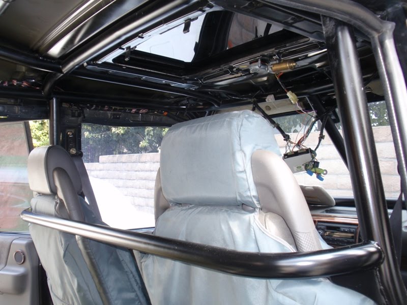

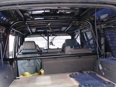

For an interior cage, adequete padding is of course a must, as is careful bar placement. In my Hybrid/Halo set up, the beauty is there's no way my head could hit a bar. Best of both worlds.
In my friend's accident, the rig would not have been okay even with a cage. I figure he personally had a 1 in 50 chance of surviving that wreck. The way the roof folded was pure chance and the only thing that saved him. A cage, even a simple hoop with down bars and some triangulation would have improved his odds a lot.
Again, just food for thought.

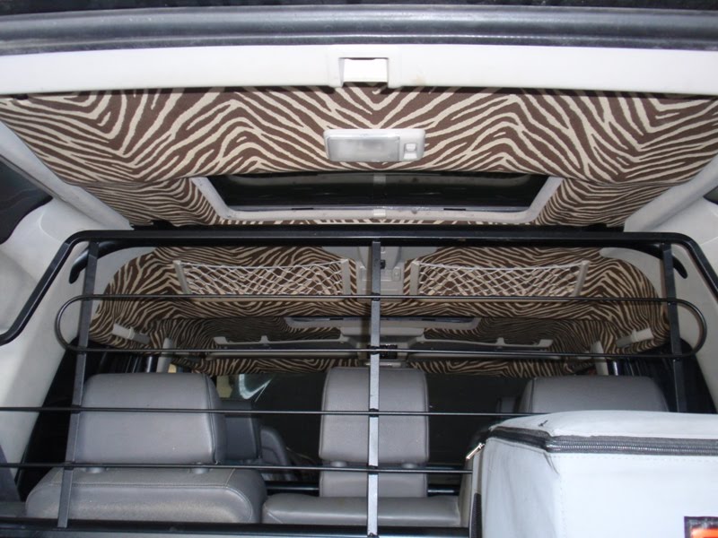

A cage is definitely on the top of my list. I'm thinking of incorporating a load barrier behind the rear seat, as projectiles can be as dangerous as the structure of the car hitting you. So it would be an interior cage at the C pillar and D pillar in the rear, and then possibly transition to the outside using sliders, front bumper and rear quarter armor as mounting surfaces for the passenger area (A pillar/B pillar).

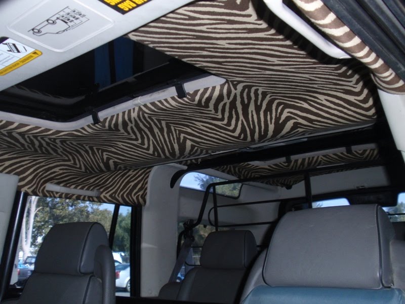

not mine, but a roll cage can be done right and still not interfere with the occupants very much. it won't save the roof, but it'll save the occupants. it could use more triangulation, but it'll do its job of saving livings, whether or not the truck is saved.
ignore the headliner. i don't know what the owner was thinking with that one...
i think it'll hold up fine for him and the bars are out of the way. it made of chromoly AND TIG welded, fyi.
there's a difference between a cage meant to save just the occupants, and one meant to save the vehicle AND the occupants. either one is an advantage to me. my truck will get a cage *one* day. no matter what.
