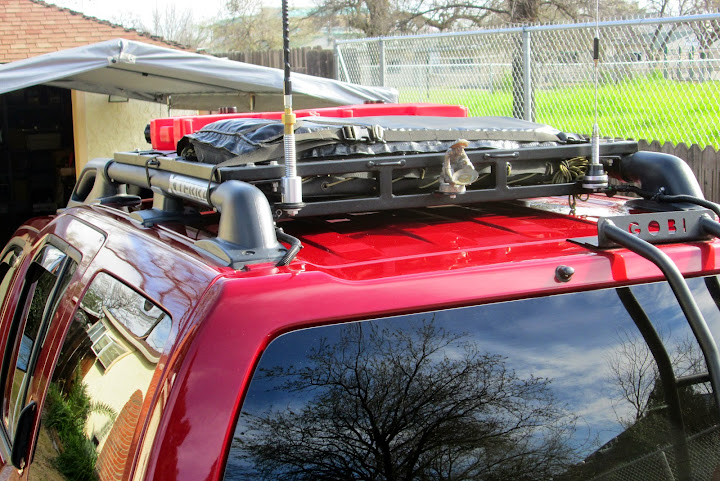

Since pictures are worth thousands of words, here is my antenna setup with the drop-in roof rack basket on my Xterra. I welcome any comments to improve the system.
Specifications
Vehicle: 2005 Nissan Xterra with factory roof rack
Drop-in Basket: Manufactured by Tony Hepler of Heps Designs, available through XterraPerformance.com http://www.xterraperformance.com/DE...RD-ROOF-RACK-2005-2015-NISSAN-XTERRA_p_8.html
Modifications to Drop-in Basket: antenna tabs, light tabs, footman loops and Rotopax can mounts welded to basket prior to powdercoating.
Antenna mounts: 2m/70cm (passenger side) - Breedlove NMO Roof Mount with ring terminal connection #78; CB (driver side) - Breedlove Pedestal Stud Mount #008 with Firestik medium spring and Breedlove quick disconnect coupling #002. breedlovemounts.com.
Antenna: 2m/70cm - Larsen NMO 2/70 SH; CB - Firestik 2' (in forested areas with low overhangs) or 3' Firefly (in desert areas).
Grounding. : 1/2" copper strap from adjacent to the CB mount to the vehicle body under the rear hatch, and a second 1/2" copper strap from adjacent to the NMO mount to the vehicle body under the rear hatch. Powdercoat/paint sanded to bare metal under connections to drop in basket and vehicle body.
Gear Bag: custom Blue Ridge Overland Gear Bag - compresses from 6" tall (height of stacked Rotopax gas and water cans to 3" tall (single can) to allow low profile. http://www.blueridgeoverlandgear.com/

I think that if your SWR is good (and you're not experiencing any rattling or crackling/static noises as you're driving over bumps), you probably don't need to worry about it. That rack does look to have a fair amount of mass extending forward of your antennas to act as a ground plane, and the ground straps you have at the rear to the roof provide a connection to act as a ground plane toward the rear.
Certainly there's no harm in grounding the rack up at the front somewhere (maybe to the bolts holding the factory rails) just to see if anything changes though... If it does improve things, then all the better.
The bigger issue I see (at least on the CB side) is that tiny rubber-ducky (size) antenna you have on there. I'd bet you could triple or even quadruple your effective range (not just outgoing, but incoming too) by putting something better (taller) on there (you have the spring... trees, etc. shouldn't hurt a taller antenna unless you're passing under 4" diameter limbs @ like 60MPH or something). My Francis 5.5' on a spring atop the roof of mine has been fine for 10+ years now even through the tight twisty trails in the forests of the Sierra-Nevadas.
Robert Bills
. . . The bigger issue I see (at least on the CB side) is that tiny rubber-ducky (size) antenna you have on there. I'd bet you could triple or even quadruple your effective range (not just outgoing, but incoming too) by putting something better (taller) on there. . . .
That's not a rubber ducky. Your eyes are playing tricks on you.
Note from my post with the photos that for CB I use a 2' Firestik only when I'm on a forested trail with low overhangs otherwise I use a 3' Firefly on the highway and in open terrain. (The 2' antenna is pictured.)
I experimented with a 4' antenna but reception really wasn't appreciably better than with the 3'. I haven't had any difficulty communicating with others in my group either in transit to a trailhead or on the trail. In fact, when compared to a setup I had on another vehicle using a 5' antenna mounted on the cowl, my 2' above the roof gets about the same range as the 5' on my other rig and the 3' gets better range.
4x4junkie
You missed the "(size)" in my post. ;)
I guess if it's working well enough for you, then no need to change it. You did say you were open to comments to improve your setup though.
I've done tests in the past of switching out numerous different antennas on the same vehicle while parked in an open elevated spot and there were immense differences between antennas that were 3 feet or less tall vs. ones 5½ feet or taller. My signal would drop from S-9 to about S-5 simply by switching out a 102" whip for a 3' Firestick, where my 5.5' Francis was still a bit over S-8 or so (seems the performance tipping point was somewhere between 4½-5 feet, or about 55-60% of a quarter-wavelength).
At least you do have it mounted up high which is something that can't be said about a lot of radio setups I've seen. Certainly that does help a lot.
Robert Bills
. . . there were immense differences between antennas that were 3 feet or less tall vs. ones 5½ feet or taller. My signal would drop from S-9 to about S-5 simply by switching out a 102" whip for a 3' Firestick, where my 5.5' Francis was still a bit over S-8 or so (seems the performance tipping point was somewhere between 4½-5 feet, or about 55-60% of a quarter-wavelength).
I'll need to experiment with a longer antennas again. I stopped using them a long time ago after I broke a a half dozen fluorescent tubes in a gas station with the 102" antenna on my jeep.

Nice rack LOL...You need to understand that for VHF and UHF that set up is fine. For CB you are asking the questions "What type of compromise am I willing to accept?" Ideal solution is put a Breedlove ballmount and plate on the rear quarter panel, lock in a 102" or 108" steep whip and use that for CB. Even better, stick that on the roof (though in a forest I'd agree to avoid that.) With these smaller antennas they are a coil and not a physical quarter wave or better. So its a compromise antenna that focuses on styling and space as opposed to physics.
With your mount on the roof, the compromises extend beyond the antenna. That basket may not create a good ground and counterpoise. Did you remove the powder coat where you connected the mount? ground strap? Did you use a star washer or something to really make sure you have a tight solid connection? These all play into the game.
The idea? Its all welded/soldered together. That is not practical so we adapt from there. I do like some of what you did and may someday shameless steal your idea for stowing the rotopacks :)

. . . That basket may not create a good ground and counterpoise. Did you remove the powder coat where you connected the mount? ground strap? Did you use a star washer or something to really make sure you have a tight solid connection. . . ?
Yes, yes, and yes. Powdercoat removed from roof basket at antenna mount and under both ends of ground straps (at rack and vehicle body). Star washers were used.
Would adding ground straps from the front of the drop-in basket to the vehicle body add anything for either UHF/VHF or CB (the original question re roof rack rails being "electrically secure at both ends of the vehicle roof" as suggested in an earlier post)?

I'd imagine the basket at VHF/UHF is fine. Anything below 100MHZ is where I begin to wonder if there is enough metal.
As I implied a couple posts ago, you probably have to just try it and see.
I agree with Frdmskr in that it's not likely to make any difference on V/UHF, but there might be some possibly it'll allow the CB to work better. Again, the improvements may only be slight though if your SWR is already good.

I don't have my SWR results handy, but my recollection is that with the 3' Firefly is was 1.7:1 with the 2' Firestick it was 2.1:1. Not great but acceptable.
I think that I'll spring for a 4' or 5' antenna to see how much I lower I can get the SWR. To keep things in perspective, I'm not using a full chassis CB, just an all-in-one Cobra 75 WX ST (one of very few radios that can be mounted cleanly in an Xterra). Its purpose is trail communications/convoys with my immediate group.
