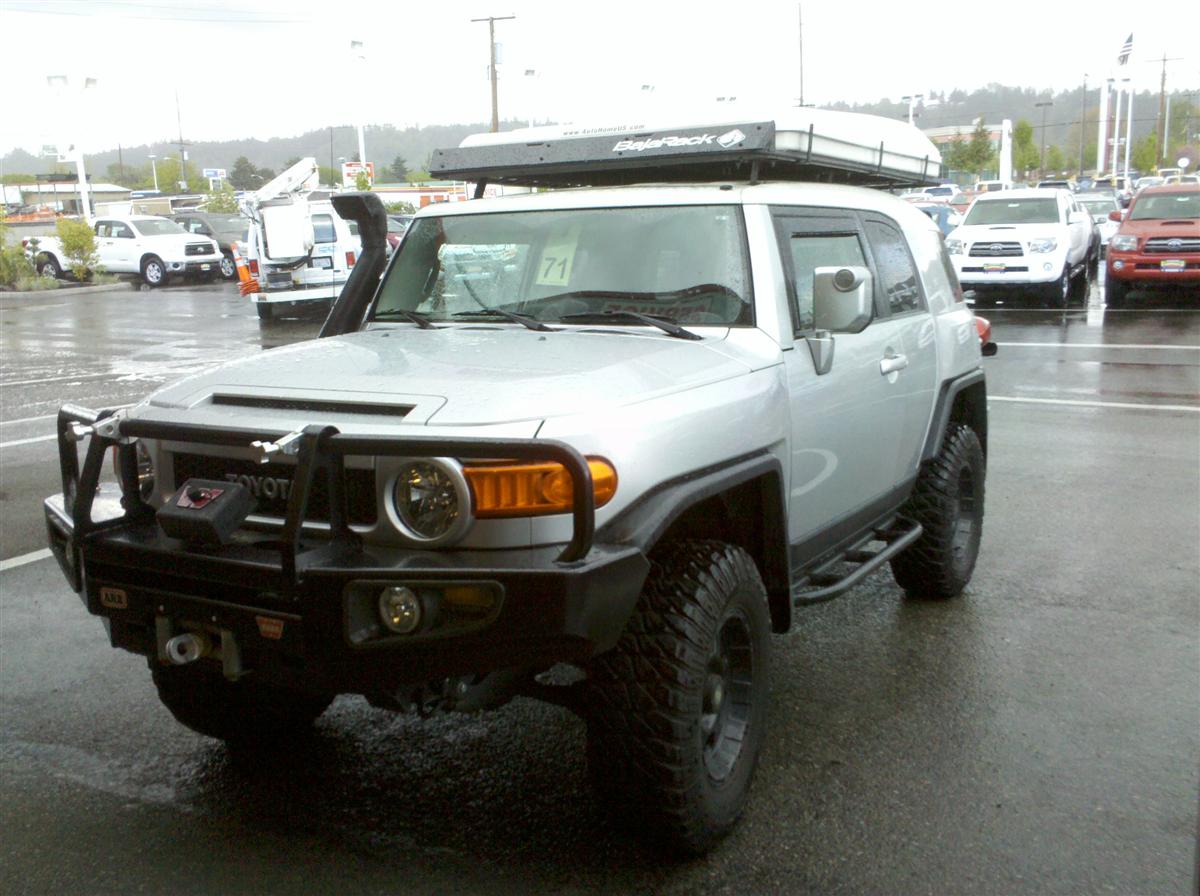

Just picked up the Airland a month back, and it is mounted to the factory FJ Cruisers rack via four Yakima 58" crossbars, and Yakima LowRider mounts.

With newer racks now out on the market for my type of rig and others, BajaRack sets the bar with making a top quality rack for half the price and more than a lot of competitors out there.
Compare how high my AirLander tent is on the factory rack with the Yakima bars, and now on a BajaRack model MG, MG standing for Maggiolina.
Tent is much lower, rig handles better at highway speeds, and MPG has gone up about 1/2 MPG.
I will have better pics in August during my vacation.
During a heavy wind I still feel the rig being pushed around some, but it is not as bad as before.
Had the rig up to about 70 MPH earlier in the week on the way home from work with no wind, and it felt very stable.
Before with the factory rack I was nervous taking it to that speed, I thought I might have to file a flight plan with the FAA.
