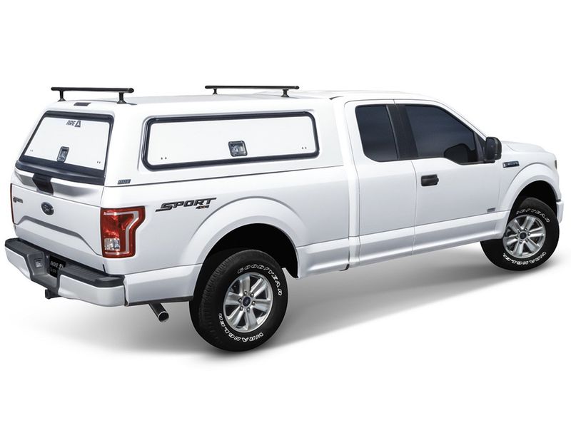

I believe that I had the 100XR model with pop out side windows (windoors). I highly suggest the windoors, and slider tracks on the roof. Just lined coolers and food along the rails and you could reach right in and grab stuff. Super convenient.

I think it was ARE had a fiberglass topper model that had an internal frame that drastically increased roof rack rating
I forget which model as I was looking for my business, but then got a tall roof van instead.
I have a Leer 100 something model and my cheapo cross bars are only rated for 150#. I've had 80-200# on the racks for 4 years until I pulled my current truck from fleet. Cap seems ok. (Just carried ladders and PVC piping on the rack)
I'd get a track type roof mount and use at least 3 cross bars to help spread the weight around at the very least.

ARE CX topper on my Frontier. Ordered it with the roof rails/cross bars. Used it a ton with my hardshell RTT. Offroad all around colorado and the mountains here. No issues at all. No extra support required. Best mod for the truck.

I'm waffling around trying to decide what truck topper to get for my 2019 Ranger. I seem to be hung up on whether I should buy an expensive metal topper (4-6k, RSI smartcap...AluCab..ect) or can I use a less expensive fiberglass one (2-3k, ARE...LEER...ect)? It seems there is not much info about weight ratings for fiberglass toppers, although I have seen many RTTs mounted on them. The difference in cost is about half. 2-3k buys a lot of fuel.
As far as use goes, the truck is my daily and will be used for expeditions only occasionally so the RTT will not be mounted permanently. More than likely, only for "big" trips. My main reason for it is dry storage and security. With that being said I am planning a very big trip in 2 years to Alaska from my home state of Florida. I am expecting some very rough washboard roads during this trip.
Any experience and help is greatly appreciated.

When i was shopping around, the ARE brochure for for the Frontier had pictures of a standard cap with a RTT installed...so i felt fairly confident it would work fine.

Agreed. I love the size of a standard soft RTT but I am wanting a hard shell. While I am going to lose space in a hard shell, there are several benefits. Smaller profile, simple and quick setup, rigidity in windy/inclement weather, easier to heat or cool....ect. The trade-off is obviously $$$$ and space. In some cases they weigh significantly more also. Heaviest I've found is 200#

I ran a soft shell Tepui RTT on my fiberglass ARE Z Series with standard tracks and Yakima round bars and towers for a couple of years and 20K miles. Obviously mostly highway but some rough washboard etc in Utah and California. No issues.

If it is not too late, ask them to install the Thule roof tracks. Something in the ordering process with that option triggers them to add extra fiberglass. They told me about 30lbs worth.
