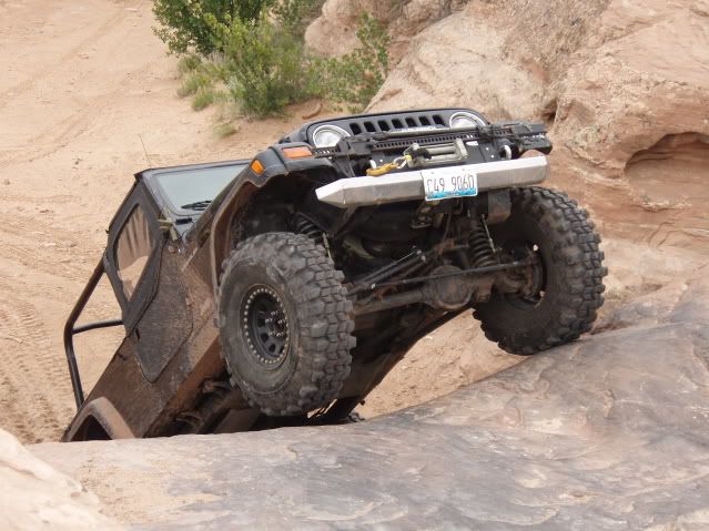

I have a Klune underdrive (David model with 4/1), so basically the same setup as the rubicon with the new box. It's all that the previous posters say.
nice to have 3 low ranges (2.7 / 1, 4/1 , combined insane low ratio > 10/1)
Takes a bit of time to learn what range and gear combo works where
the low low is sooooooo nice for the real technical stuff. Helps keep the breakage down as well

I was wondering when someone was going to mention the Klune. Its been around a while and never got the love it deserved. Basically the front end of a 4sp Atlas...Not sure if it was an "in conjunction with" kind of deal or what but it works! I just can't get them to answer an email...Grr!
There are alos other options out there for crawlboxes...
Box4Rocks
Rooster
BlackBox...
All of them (including the Rubi) operate off the same concept...using the planatary drive off the NP 2 series t-cases. The lighter ones usually run the 3 Pgear assemblies while the HD units run the6 gear ones...
