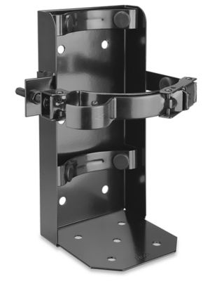

This is the type of mount that i use and they make them big enough for a CO2 tanks
