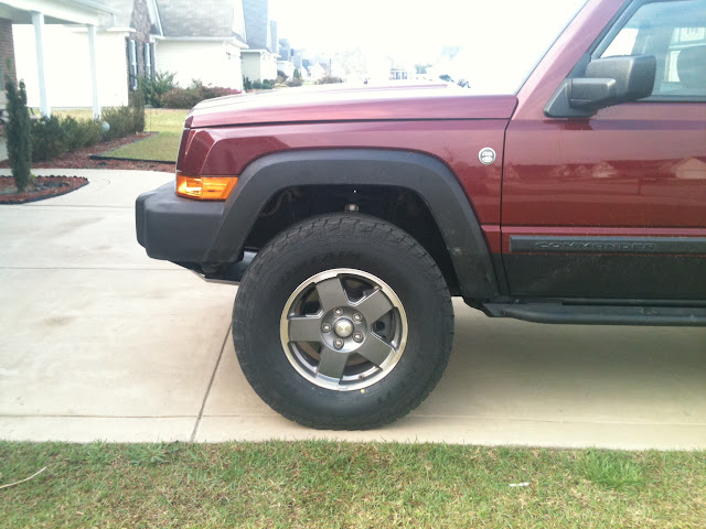

Thanks for all the compliments guys. The biggest change since my last update was getting 33" tires stuffed in with just a 2" lift! not a easy thing to do LOL.
Passenger side pic I cut and folded over the pinch weld as well as removed the rear heater lines. So far the AC lines for the rear seem to be out of the way so I left them in for now.
I also had to trim the wheel flare I like the way it turned out I think it looks better now.
before
after
On the driver side I had to completely cut the pinch weld out. Folding it over wasn't enough it was rubbing so I cut it out grinded it down ran a bead down the seem just in case and painted it up.
I repainted the black portion with a easier paint to take care of. My wife also hand painted the commander letters for me I love the way it turned out.
