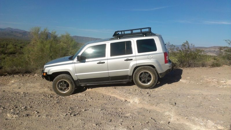

Saying goodbye to our JK! Patriot is now our expo rig!

Nice pat dan. Why would that not work for you? The clearance issues with the pat and tire size are against the strut more than the body. I am not running huge tires anyways. Darkrider, He left because of his cvt failure. Yet another one. I won't be going anywhere with mine. I have the 6sp automatic/NON CVT. Solid ride. If you get one...walk....no.....RUN AWAY from a CVT equipped one. Even The expo's own Patriot is developing trans whine. Terrible system that should never had been put into the patriot. Since I only thought of this over the weekend, I never had a chance to call Airlift performance to see if they can get the bags and system to work in this way. More on this, this week once I call them. As a bonus compared to the systems in vehicles now, I will have control over the front and rear separately. I hope they can do something. We will see what happens anyways. The winch mount, lights, rhino rack etc are all being installed this spring...around may or june. The rhino rack will be only mounted when traveling....most times it will be cross bars for our bikes and snowboards.

Well, I have been talking to air lift. They said, Obviously they don't have anything. But, their universal build kit "SHOULD" work. I have to look into it further. I think its going to work since All I am essentially doing is replacing the strut/spring with strut airbag combo. Height would be dependant on air pressure. So. I need one that on "normal" ride settings, it's stock Patriot lift height since 235's can fit without lift, then add air as weight or lift need dictates. Hmmm...what could go wrong..ha ha ha! Maybe a new cool suspension for the patriot will come from this. Breakout my welder, and fire up the powder coater. Air suspension is going in!1,
Edit, I am installing the 3H/3P system. It has 3 height settings, and 3 pressure settings. All controlled by my iPhone. fire up the jeep it will be on setting 2 as normal. that's going to be set at stock height and "spring rate" . It will drive and ride like the stock pat. Hit the up switch and it will raise the jeep 2 inches. Keeping close to the stock spring rate, add in the extra pressure of the rear when more weight is added automatically keeping the jeep leveled as it should be. on setting 1, the pat will lower 1" I hope....or maybe 2. But I have to set it so I think I can drop it 1 inch. so highway driving will result in better milage. I think this is getting interesting! ha ha. I will keep up to date on the progress when I get stuff ordered and working on the install in my fabrication shop.

Been researching LOADS this week. I am not going with a heavy off road wheel. Not needed on a light vehicle like the patriot. I am going to install a strong lightweight (rally type) wheel on it and Kumho at51s. P series tires and lightweight wheels will make the rig drive as intended and keep milage up! I noticed a lot of land rover builds and Cherokee/grands using this type of wheel on their rigs with success! I like the look of certain ones and I think I may put the same wheels on my micra too. ha ha...low build using the same style as the lifted jeep build. ha ha.
