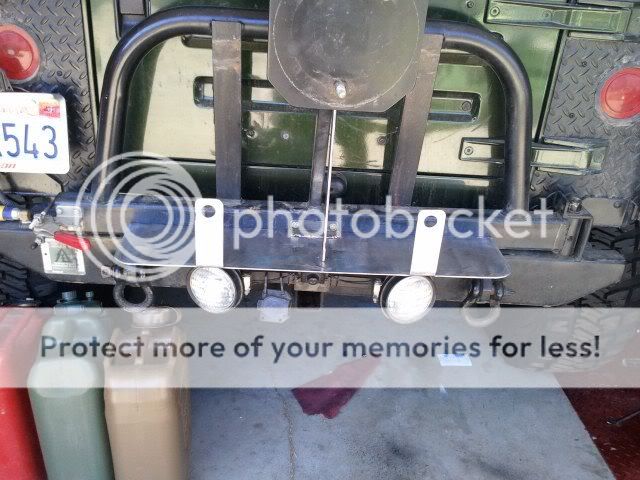

So after a couple of days and no replies, I gave up on some fancy store bought gas / water can holder
I didn't want to ruin the integrity of the bumper so I made an adapter to hold these style cans, so if needed I could go back to steel.. not sure why other than if I decide to sell the TJ.
this is what I started with a slight lip to hold old school gas cans,
In my garage, I found some 1/8" hot rolled sheet metal and some 1" angle that will slide into the slot on the swing away.. I traced a pattern, cut it with the plasma, made some bends.. welded the two together.
added some flat stock and test fit the unit, drilled and tapped some holes to secure to the swing away
drilled some 1" holes to hold the 1" nylon webbing

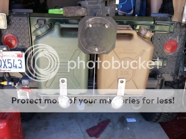

dropped the scetpter cans into place for more assurance
I removed the original clamp brackets and added some ratchets from some harbor freight tie downs I had while using the existing tapped holes
quick shot of semi gloss rattle can and I called it done...
I made my departure angle better and I have a skid plate for the cans now instead of risking the loss of water and fuel on the trail, overall I rushed this mod but I'm glad it's done.. now I'm on to the next thing on my list..
