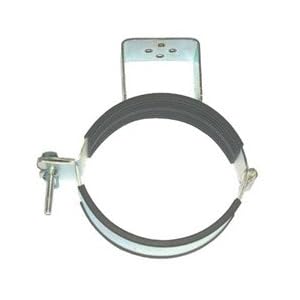

Stumbled across this little gem and ordered it last night..
[ame="http://www.amazon.com/4Bs-Bracket-TH-112-Tank-Holder/dp/B0037QFNYM/ref=wl_it_dp_o?ie=UTF8&coliid=I2ZCDWAPWJ40KF&colid=1JFA3RKGCZ8EF"]Amazon.com: 4B's Bracket BU TH-112 Tank Holder: Industrial & Scientific[/ame]

That looks interesting, but I still haven't figured out what size cylinder it fits. Not enough info and the only reason I even know it's a cylinder holder is because they chose to tag as that in Product Description. And no measurements that are really helpful.
I guess they're not exactly paying the big bucks to whoever wrote that item up. They have to classify things creatively if they expect people to search and find it on the 'Net. But if it does fit, it looks a heck of a lot more secure than a J-bracket, provided there's a plate for the cylinder to rest on below where it's mounted.

I ordered a smaller one of those just the other day to mount my 20lb CO2 cylinder in the back of the Disco. I was just using rachet straps before and it made me nervous :eek:

Thanks for the confirmation. I still haven't settled on how to make the final tiedown once I get a cylinder settled in it's new home. The cheezy $4.95 tank straps seen on the internet don't inspire a lot of confidence. I may be able to fab that part. I'd rather spend that money on decent materials than on something inadequate, even if somehow sanctioned by sale as a safety item.:coffeedrink:
I'll actually be mounting the tank inside my trailer on a back PS corner.. The location will make sense when it's all together.. The location is good due to the fact it's at the rear, near where the stove will be set up. It's on the fold out side of the tent and that zip off cover that makes it a PITA to get at anything on that side of the trailer when the tent is set up, so it leaves other spots open for things like the ice chest and other storage boxes that I'd be trying to get at more often.
10ft hose oughta about get the gas anywhere I'd want it.. Stove, tent heater, lantern.. If not, it won't be to difficult to move the tank to wherever it's needed.
