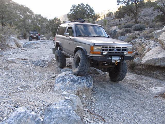

My 1990 Ford Bronco II:
Engine is original (ODO shows (1)85K, but is probably closer to an equivalent of 230K given the amount of time the rig spends in low range). Trans is a M5OD from a same-year Supercab Ranger, but is also running it's original innards. Axles are from an Explorer, which were needed to support the 35x12.50 tires.
Built it about 10 years ago, it's been a great rig (driven all up & down the west coast with it). Biggest issue to date was an output bearing in the trans that very gradually started making some noise, which I chose to just swap to a later (improved) design trans rather than repair it for almost the same cost). More recently I had a leaf in a rear spring break (rock crawling finally did it in I guess), and fixed a couple power steering leaks, and new body mount bushings, but overall I've been quite happy with it.

Wow, 4x4junkie, u still wheeling that thing! I miss my 85b2, and really regret selling it.
Sent from my SAMSUNG-SM-G870A using Tapatalk
