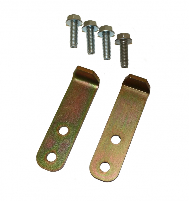

My springs keep falling out when Im fully flexed. i tried the bolt on spring retainer kit from ironrock offroad and they worked for a while but one of them ended up braking off. I think im just going to limit the flex with limiting straps to solve this. can any of you show me how you solved this problem? I have an idea of where to put the limiting straps but I wanted to see what others have done just incase theirs a better way than what I already have in mind. Thanks for your advice in advance.
i threw some limit straps on mine, only 3" of lift but still looses coils with the sway bar disconnected
have you had any problems with this set up?? i saw this too and im trying to decide witch way is better.

I actually have the uppers installed in my Jeep. I just have a 3" OME with Bilstein shocks bought through Kolak. The IRO Retainers keep the springs from popping all the way out but the other problem is when you flex that much the springs come out of the rubber Spring Isolators and of course just smash them instead of going back in them correctly because when your twisted your not at the correct angle. It's pretty frustrating.
Sent from my iPad using Tapatalk
That's what the lowers are for (second picture and link), keeping the springs from pulling up the rubber isolator.
lacofdfireman
My lowers have never pulled out but my uppers pull our even with the isolators and smash the upper isolators on the way back in...
lacofdfireman
Well never mind above post. The lowers are out also. Here is a photo of the uppers out of the isolators
Also anyone have a photo of how the lower isolators keep the springs in? I didn't get any instructions with them just them pieces.
