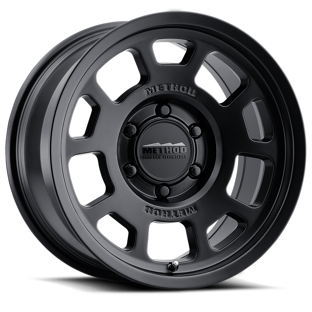

701 Method
I like the Methods, they are a close offset to the AEV's but have 9mm less offset, in conjuction with the 9" wide rims vs 8.5" aev's it bumps the tire out another 15mm....not much, but still worried it's going to look funky....
