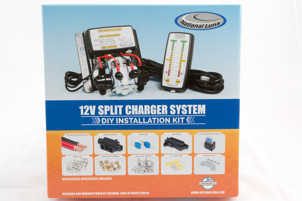

I have a National Luna Intelligent Solenoid in my Cayenne. I just got a 100AH lithium battery and would like to use the battery on an upcoming trip.
What are the drawbacks, if any to use my existing system ? I normally have a Gp27 AGM battery but reducing weight from 70 lbs to 24 would be nice. Thanks in advance.
I could always bring the battery into the hotel and charge with a charger if need be.

DiploStrat
There are two potential issues:
— The charging voltage of your vehicle may be a bit high for a lithium battery, but this is probably not a real world issue depending on how long you drive and assuming a decent BMS as a fail safe.
— The connect voltage of the National Luna VSR is probably too low, that is the resting voltage of the lithium battery is probably always higher than the connect voltage, so the National Luna may never disconnect. This may or may not be an issue.
In the long run, you probably want a battery to battery charger.
