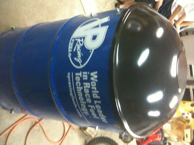

You should build a UDS like this. (ugly drum smoker) I just built this a couple weeks ago and last weekend we did a pork roast, a rump roast, and a tri-tip. It cooks and holds temp great. I used a rub from www.texasbbqrub.com. They make some good stuff and it only takes minutes to prep before throwing it on the smoker. :ylsmoke:

Tell me more...I have a 55 gallon drum and would love to make a smoker
MossMan
It's pretty easy really. Add a few breather holes in the bottom, a grill, and fire basket and start cooking. :D Here's some of the build:
Finally got started cause I'm ready to smoke some butts. I started with a VP racing fuel barrel that I got from a buddy.
I've read a ton of threads here, at thesmokering.com, bbqbrethren.com, the Texas BBQ Rub forums, and others and decided that a good donor grill would be the best source of parts. So I found this a Big Lots for $29.
It was a sealed barrel so I had to cut the lid off.
MossMan
And of course I did it wrong. :flipoff2: The lid fit ok but it wouldn't have sealed well at all. No problem though. I just cut the rim off the donor grill and made a better seal. :smokin: Not pretty from the inside but it should work.
Added the intake holes and grill supports. I used three 3/4" pipe nipples with two caps and one ball valve. I had a 1" drill bit for the holes. And I went ahead and added supports for two grills with eye bolts.
Then we loaded up an old pallet and burned out the inside.
It burned really well and you could see the inputs drawing really well when a couple pieces of burning wood fell on the ground. It was sucking smoke in like a vacuum. :)
Tonight I'll fab up the charcoal basket, install the thermometer, wire wheel the inside, paint the outside, and hopefully if I get all that done have a good seasoning/test burn. With any luck I'll be cooking on it this weekend. :smokin::smokin::smokin:
MossMan
The intake holes at the bottom are your temperature control. Two have removable caps and one has a ball valve. It is said that you can keep a very constant temperature using these. From what I've read one cap off and the ball valve about half open can maintain temps at about 210* for 8 to 12 hours easily. Of course, every cooker is different and has to be "figured out" and the possibility exists that mine sucks and can't be regulated. :laughing: Only time and testing will tell.
You can google UDS or ugly drum smoker and get tons of hits. I read a lot at these pages and founds some good help and examples. thesmokering.com, bbqbrethren.com Give it a shot and let us know how it turns out.
