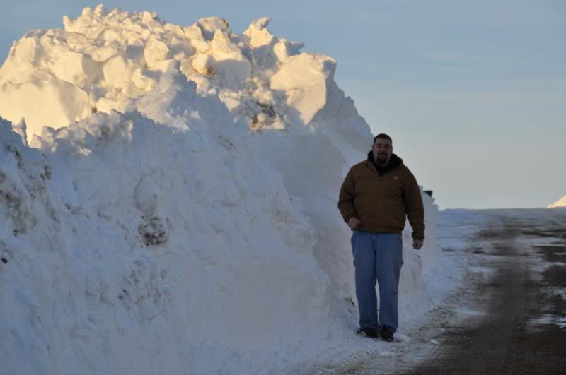

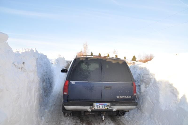

RusherRacing
lets pray we don't have a repeat of last year.
Oh! So YOU got all our snow last year!:coffeedrink:
I guess that's where the north-east winds off Lake Superior sent the snow:snorkel: (we got a whole bunch of COLD, and a little snow)
