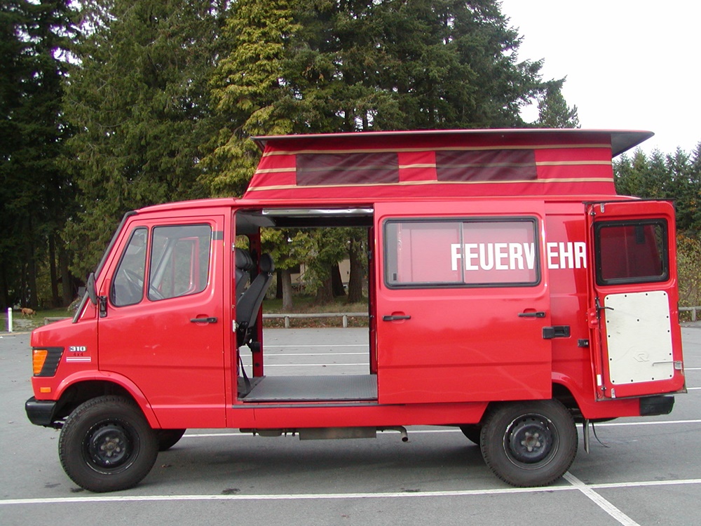

Imported from Austria to Canada in January 2010 as a Fire/Rescue Vehicle with 39,950 kms. It now has 63,600 kms (39,520 miles)
2.3L I4 Stock Gas Engine with a 5 Speed Manual Transmission

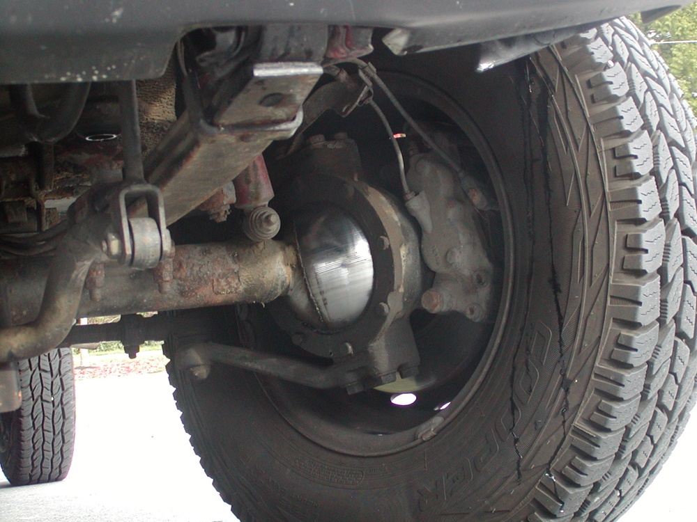

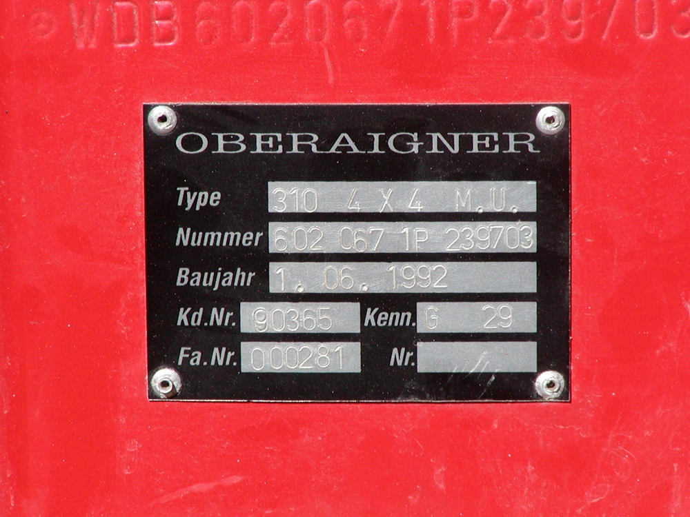

4x4 Conversion performed new in Austria by Oberaigner Powertrain GmbH, an approved upfitter/partner for Mercedes-Benz
The 4x4 system is based on the W460 Series Mercedes GWagen and includes:
711.110 Iron Box 5 Speed with 1:6.15 first gear and 1:1 fifth gear.
VG-080 shift on the fly GWagen Transfer Case, operated pnuematically by an on board compressor system.
Heavy Duty, Wider Commercial/Military GWagen axles with 1:4857 (34/7) differential gearing, including a rear hydraullicly activated locker.
The Custom Pop-Top was designed, built and installed by GTRV here in British Columbia.
Highway fuel economy averages: 16.5L/100km, 17 mpg/Imperial, 14.5 mpg/US.
Tires are Cooper Discoverer 235/85-R16 A-T3 with 15,800 kms (10K miles).
This is unique vehicle and would be an exceptional platform for an Expedition Grade Camper.
As it is mostly unfinished inside, it is a blank canvas for a creative custom interior. Westfalia Syncro on Steriods anybody?
I had lower front fender and inner/outer rocker panel rust removal professionally done in January 2014. Photos of work done are available.
The body is sound with very minimal rust and the chassis, mechanicals and electrics are all excellent.
