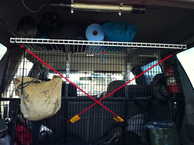

in the back of Patrol sits our Waeco 40L fridge on the left, next to that sits a large 40L plastic tub with all of the food. Ontop of this sits our clothes bags, then all the sleeping bags and pillows. Now this started getting messy and a pain to get anything. Luckily we already had a cargo barrier installed so I thought I'd love to get one of the purpose built ones as per this example

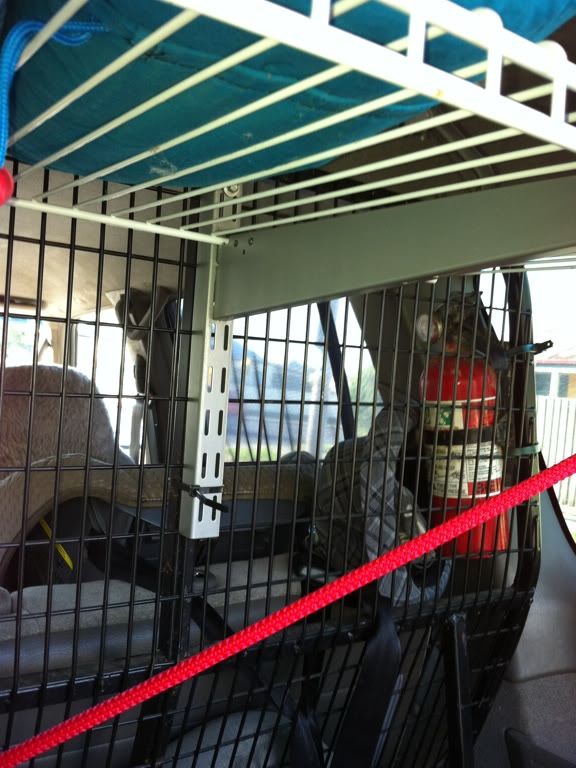

but they are hella expensive for what they are. I thought, while wandering through a hardware store, why not use one of the inexpensive clip and bracker style ones that you see in wardrobes. So $20 later, voila
works great, all the sleeping bags and pillows jam in the space and dont move at all, and no squeaks. Also is easy to take out if needed.

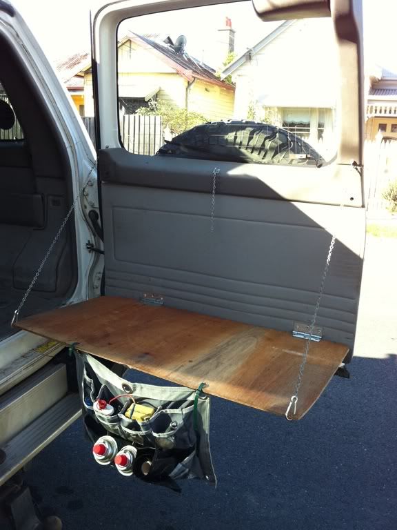

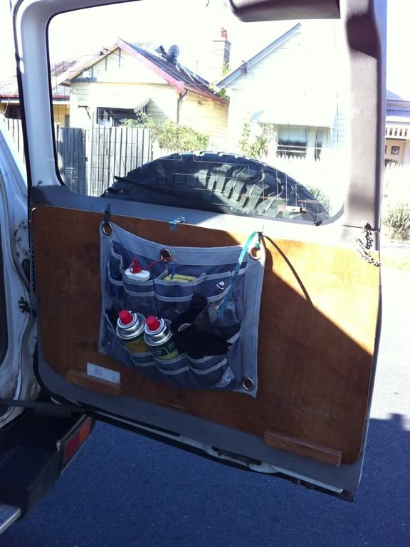

Then we needed a drop down table so found a daggy bit of plywood in the shed that happened to be the right size, sort of. Drilled a couple of hinges on, grabbed some bits of chain and there we go. Works great, cost next to nothing. Do need to swap the chains for cord though as they rattle. Then thought need somewhere to sort the odds and sods that you accumulate so grabbed a compartment bag from the hardware store for $10, attached with a couple of zip ties and now can store the bits and pieces and still use the table.

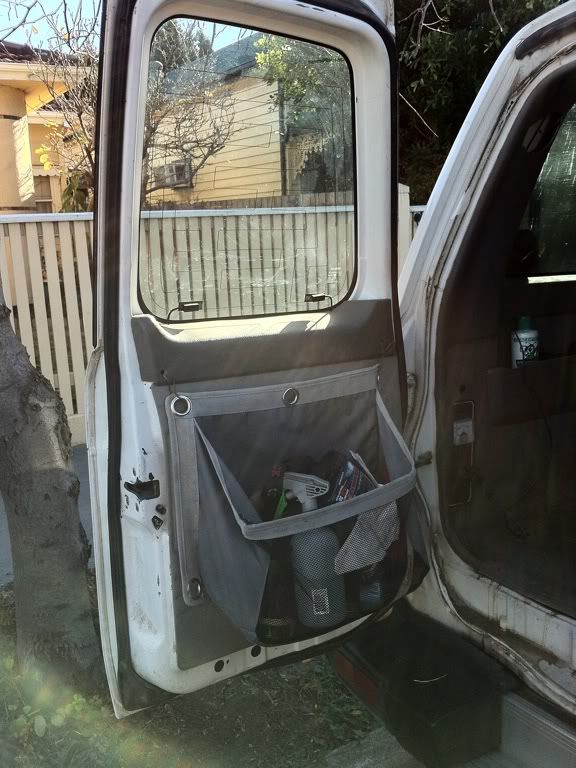

Then as the other door was now empty grabbed another bag and use it store a spray bottle of water, some hand disinfectant and a whole bunch of stubby holders and other bits and pieces
Now with the shelf in place the lighting situation was a bit dark so grabbed a cheapy fluoro tube light, some tool clips and a couple of screws and popped it in above the door latch on the roof. Best thing is I can just unclip it and have exterior lighting if I need as well. Just plug it into the power board at the back which is there for the fridge.

I'm really liking the fold down table and swing out/down odds and ends holder. Very clever.

I like the high shelf idea. I never seem to use the rear to the full height capacity anyways. Something like that could help organize things better.

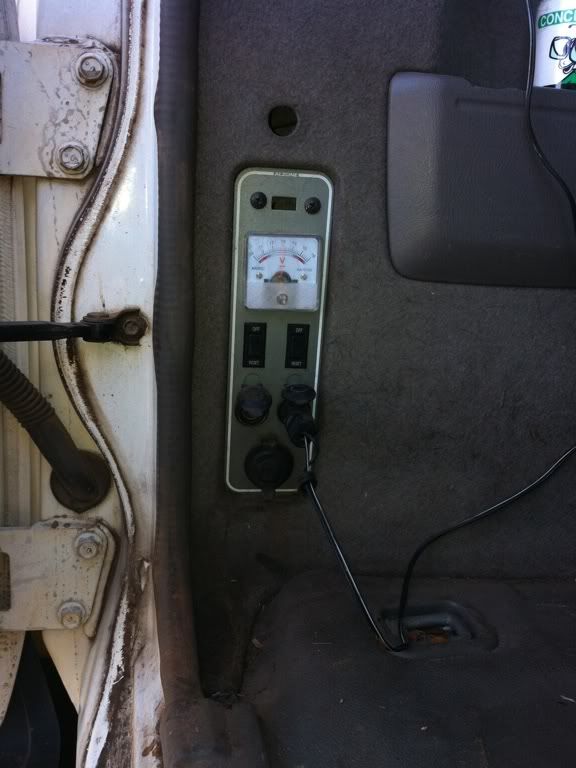

The power board is from ARB, great bit of kit with two switchable Hella plugs, plus one cigarette plug. Also has a voltometer. I've found it invaluable as I run a Waeco 40l fridge but only a single battery so having the gauge there handy at the fridge is great. They are made specifically fir the GU Patrol as they take the place of a small inspection panel.
