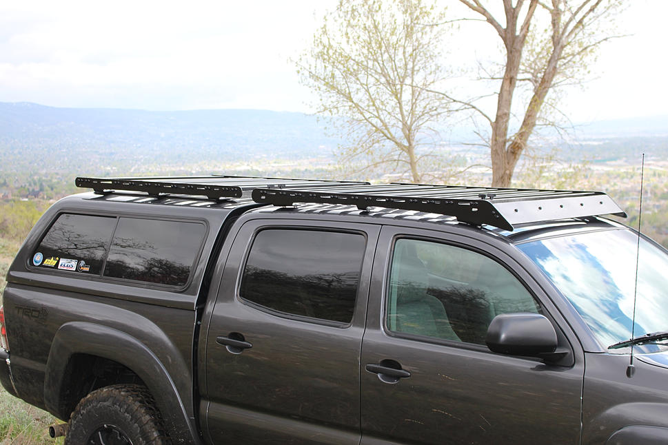

Thanks! Not sure if you noticed or not, but one of your racks (well two actually, truck + camper) is on the wish list. When I look at them side by side, I honestly think the Prinsu rack is cleaner-looking than the Front Runner.

http://www.prinsudesignstudio.com/#!2ndgen-tt-toprac/c12ps said:
e5eb7b_ed123946f34c48e199ace7e3902b63e1.jpg_srz_969_646_75_22_0.50_1.20_0.00_jpg_srz
