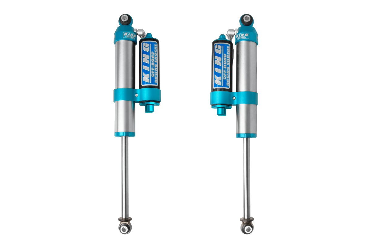

Unfortunately I have to replace the expensive rear shocks. The lower mount of passenger side rear shock snapped off at the shaft (where the threading starts). Luckily it didn't happen in the backcountry or during high speed manuevers.
I am replacing dssv shocks with Kings that should arrive next week.
skyfree
Kings are so much beefier. I wonder how you got just the rears though? A couple years ago when I was doing this I found that they would only sell complete sets of 4 including the expensive front coilovers. Maybe things have changed since then...
