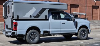

#95 has landed. We drove a portion of the way home the day of delivery then up early and bombed home to beat an inbound winter storm. With one night under our belts, I can say it was worth the wait. More to come after we get settled in.

Here are some images of #95 from the last few days. Tried to color correct the pickup itself a bit because the Ford Glacier Gray Metallic Tri-coat paint shows up much more blue in all images than it does to the eye. The below seem like a fairly good representation of how it looks. Was a bit nervous of how the Battleship Gray camper would match the bluish-gray pickup, but in person, they are a home run. Super happy.

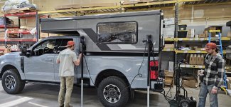

In all our haste, I didn't get final photos of the team or my wife and I in front of it on the big day. But was so engrossed in great conversations that install time came and went and it was time to get on the road and stop distracting them from the rest of the campers in various states of completion. Could have stood there another 2 days talking details.

Stock suspension? There's no detectable rear-end sag.
Curious to know how the camper attaches to the truck bed.

Hi Paul, Yes, stock suspension on my F250 for now. It has 3,200lb payload rating. Camper is 1,600 dry. We had a full propane and two batteries and about 10 gallons of water. Little to no camping gear or food with us, but all my tools and recovery gear in the pickup and the two of us. If I had to guess, we had about 2,300lb total with us in the cab. It sat really nice and drove like a dream. So nice that I'm scared to mess with the suspension. Ha. But then, we haven't driven any trails yet and that will dictate what suspension updates are needed.
It was just starting to touch the helper spring, but the last 5" front and rear of the helper spring are not touching by over 1/2". We hit plenty of rough roads and woops on the backroads home and never felt anything abrupt as it transitioned to the helper spring. And the overload spring up top not even close to touching (2.5+"), though I can see it did touch that pads at some point while driving. In our Tundra with air bags and E tires a campers, I definitely had to slow down to the curve warning sign speed for two-lane highway curves. On the 700 mile drive home, we took mostly 2 lane rather than interstate. I tested it out on some curves and could comfortably go 10mph faster than the curve speed recommendations. Meaning, 40mph curve at 50mph or 50mph curve at 60mph. Really impressed with the stock suspension.
Camper attaches with the proprietary and patented Supertramp system. Brackets mount to the front floor of the pickup bed and pins on the front sides of the camper go into bracket slots. Then brackets in rear of bed and camper that use torklift turnbuckles. With the rear of the camper held down, the pins and front brackets keep the front of the camper from moving up/down, forward/backward. No need for front turnbuckles nor the associated crawling around on your belly trying to hook up and close turnbuckles through portals in the camper. Slick setup.

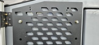

I mounted a set of ActionTrax brand traction matts on the STC rear molle panel yesterday. I prefer the material of the ActionTrax (more flexible) than the MaxTrax (more rigid). Had a medium blue set that we thought would look slick with the gray camper and then had also bought a black set as we wanted a total of four. Ended up liking the black set better and considered putting those on the outside and blue on the inside, but fickle us decided all black would be more our taste so another set of black are on the way.
As for mounting, STC has four holes in the rear molle specifically spaced for Maxtrax brand traction boards. Of course the ActionTrax use a different pattern. Blah.
MaxTrax uses 890mm (35.0394") by 270mm (10.6299).
ActionTrax uses 873.125mm (34.375") by 266.7mm (10.5").
The width is juuuust close enough that it will work, though not as smooth as if the width was exactly appropriate. I wanted to only re-drill two holes rather than four plus there was not a good place to re-drill all four without overlapping at least two of the new holes with existing holes (effectively making an oval or an 8 shaped hole) which I wanted to avoid. I chose to mount the mounting pins in the two existing lower molle panel holes and then redrill only the two top holes. That would also space the new holes far enough away from the two existing top holes that the holes would not overlap. I put a scrap piece of Hardie Plank siding behind the molle while drilling to avoid marring the camper after the drill bit passed through the molle panel. Marked the center of the needed holes by mounting the boards on the two lower pins and marking the center of the holes with a marker, removed the boards, center punched the molle panel so the drill bit wouldn't drift, drilled the hole first with a midsize bit then with the final sized bit.
If I'd planned way further ahead, I may have inquired if STC could drill the board holes at the needed ActionTrax spacing rather than Maxtrax spacing. They could potentially update their pattern and have one panel for ActionTrax and one panel for MaxTrax, or, perhaps a single panel that has holes for both spacing but offset far enough to have all eight individual holes. ActionTrax are becoming as popular, if not more so, than MaxTrax, so might be worth STCs consideration, which I intend to mention.
I used Maxtrax brand board holder pins. They make make three versions (standard boards, extremet boards and hybrid) and each can be purchased with 17mm studs or 40mm studs. I had the standard pins set with 17mm studs. The 17mm will fit on the STC molle panel without requiring the stud to be cut off like on longer studs. They come with a washer and nylon lock nut, but I also used loctite.
The ActionTrax standard boards are slightly deeper than the Maxtrax standard boards . On the Maxtrax pins that will hold two or four boards, two ActionTrax will not allow the knob to close for two boards; you have to use the 4 board knob and then there is quite a bit of play (see image below). ActionTrax says the standard board pins will hold 3 ActionTrax. The longer pins, meant for four Maxtrax extreme boards will carry four standard ActionTrax boards. I'll likely swap out to the longer pins when we get back from our April trip, but for now, they are mounted and I'll bring only 3 boards rather than 4.
Freshly-drilled set of upper holes for ActionTrax which are slightly narrower and shorter than Maxtrax hole spacing.
This shows the spacing with two pair of Action Trax. They are thicker than Maxtrax so I can't close the 2-board pin; only the 4-board pin and that leaves a gap. Three ActionTrax will fit with the 4-board pin closed and I'll add the third board next week. Meanwhile, I'm using two Giant Loop brand Pronghorn straps to keep the boards from moving.

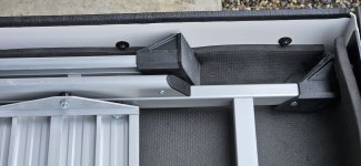

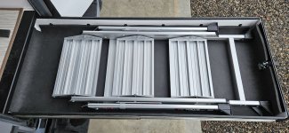

Received our Little Giant 'Jumbo Step' 3-step stool to replace out much loved Little Giant 'Safety Step' 3-step stool. The 'Safety Step' model just won't fit in the STC rear drawer, but the 'Jumbo Step' will with minor mods. The 4 step version is too long so we stuck with a 3-step. Bonus it this model is a fair bit lighter weight than the 'Safety Step' model.
Like the 'Safety Step', first line of business was drilling out the rivets that secure the flip-up rail so it can be removed. As rivets like to do, they spun when trying to drill so I cut a slot in the other end with a dremel tool and held it from spinning with a large flat blade screwdriver as I drilled it out. Tapped out the pin then cut 1/4" off of two of the plastic feet to make the overall width narrow enough to fit in the STC rear drawer. The other pair of feet are narrower so no mod needed on them.
Lined the drawer with foam to keep rattling and movement to a minimum. Top of the step is about 20" below the floor of the camper. A 4-step stool would be perfect height, but it won't fit in the drawer nor vertically in the back seat of the pickup where we used to store our 3 step. I didn't want to store it in the back seat sideways, on the floor in the camper, nor lashed to the rear molle, so stuck with the 3 step. I'm having a 4th step welded to a receiver extension to split the difference (about 10" step up from the top stool step and then another 10" into the camper). More on that once it's complete.
