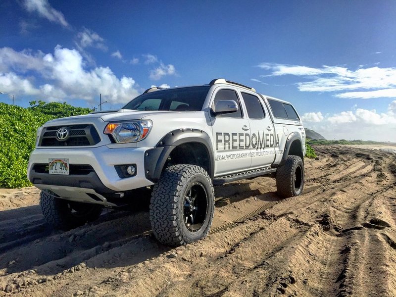

Yes, you are correct. Looks and style are playing a huge roll in this decision. 2" doesn't look any different than stock from my eyes.
Here is a pic of 33s on a 4.5 RCD kit. Looks pretty good to me.
image-jpeg.791588
deadbeat son
I understand, just remember this is a site where form often follows function so you'll probably get a lot of push back or rolled eyes.
Regardless, the only thing I would caution you about is resale. Many people would likely be hesitant to buy a used truck with its crossmember cut out to install a DB lift. If you trade cars regularly, that could be a concern.
