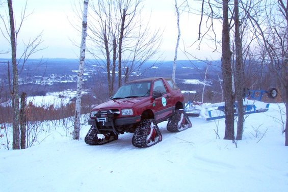

Hardly even looks the same does it? :sombrero: I got a little crazy with a sawsall....
It had a vw 1.9td, got 35mpg at 65mph (with 35" tires, not tracks).
Now it's a VW TDI (mechanical pump, non-electronic) with complete Toyota drivetrain.
Sustained high loads were tough on the Suzuki transmission - I blew up 3 old, non-rebuilt ones. ACME recommends a quality rebuilt trans with sythetic oil if you run a 1.9td or a 1.9TDI.
Or the toyota conversion :D

I'm working with one of the cities here in the SLC valley right now in an effort to open up a new nordic skiing park. They are quite interested in the idea, and if it flies, will need a couple grooming options next year. It could be volunteer grooming, and that is one of the reasons I bought the Zuk.
I've read the infamous/famous thread on Pirate4x4 and your posts about building a Tatou knock off............
deepmud
I know that grooming with light Suzuki's has been done - I don't know any contact info for these guys, I know it's Maine.....
The name of that picture was "groomer on Alton Mountain" - perhaps you could find them using that?
WRONG! Not Maine. New Hampshire - I googled Alton Mountain Grooming and found them.
http://mountmajorsnowmobileclub.com/trail_conditions.htm
They have that pic of the Suzuki up on their website, so I would guess it wasn't a disaster they wish they could forget :D lol
