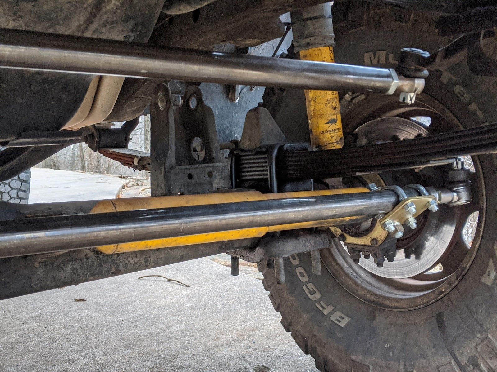

The key was a dual steering arm produced by Aqualu that enables the steering drag-link to be positioned above the springs while the tie-rod remains below, the downside is that this steering arm costs over $500USD new. Other manufacturers (All-Pro) who made similar steering arms, no longer produce them.

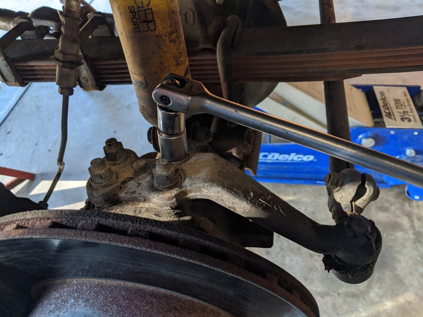

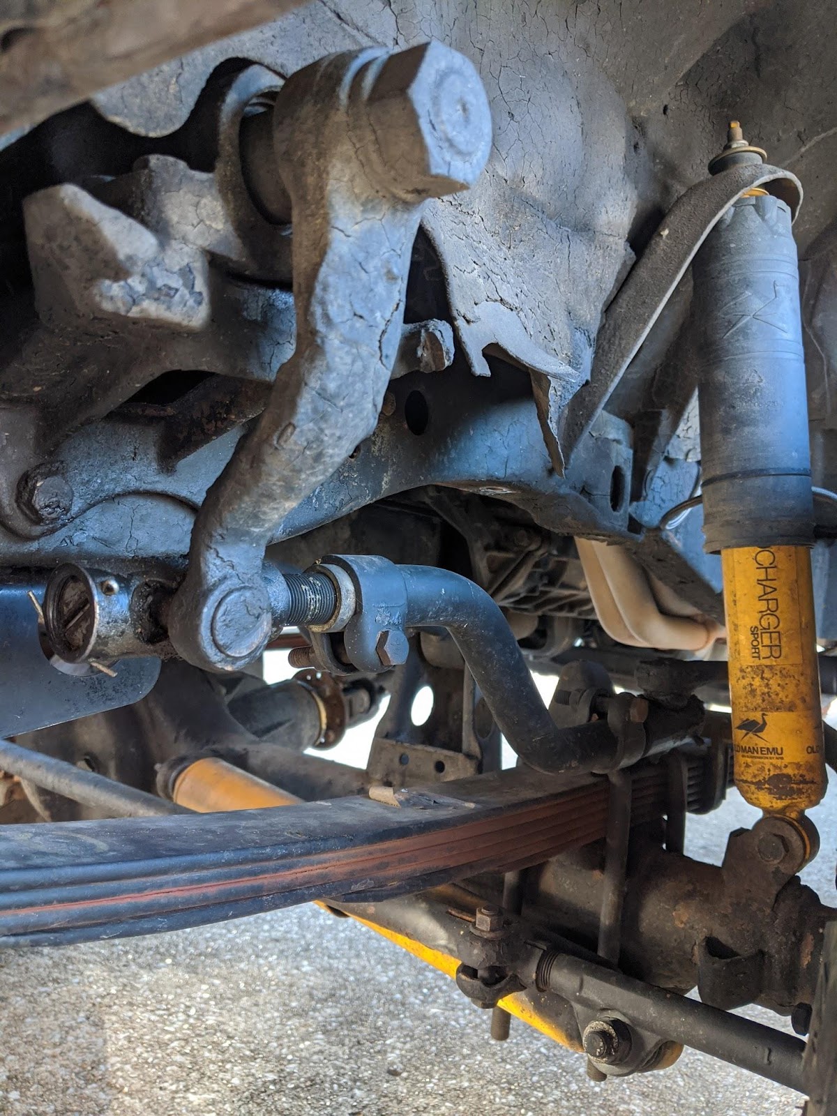

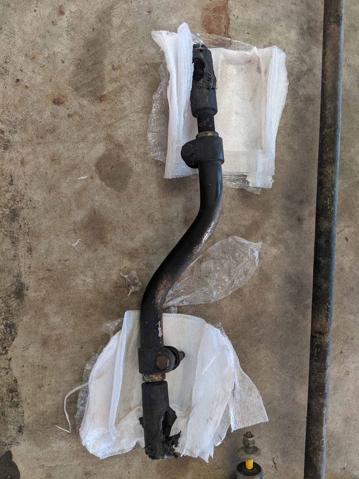

First we removed the ProComp S-shaped drop draglink we'd installed when we did the OME suspension years ago, followed by the torsion bar, factory tie-rod, and passenger-side steering arm. We'd also previously removed the factory swaybar)

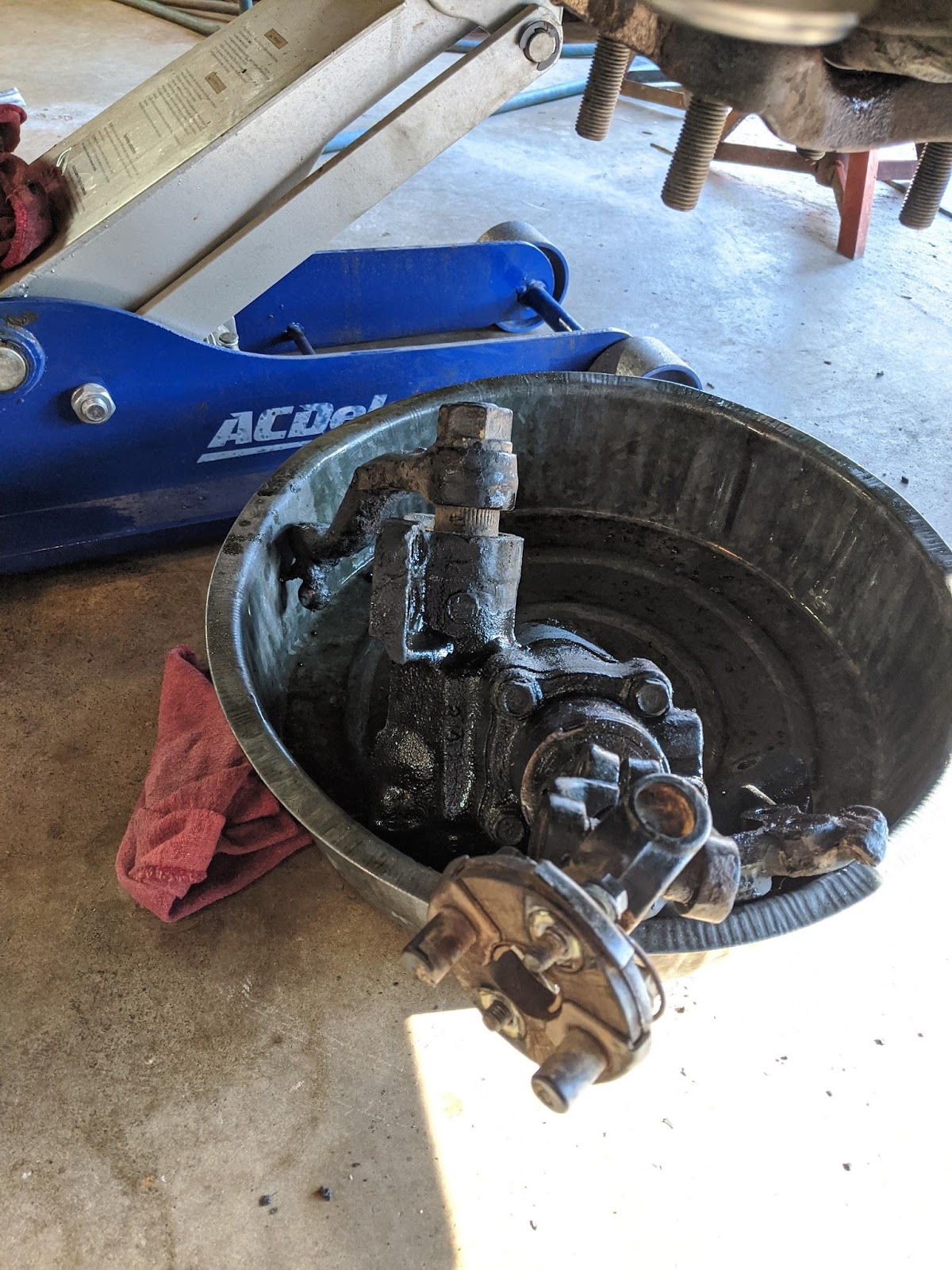

Then the factory push-pull steering box was removed.

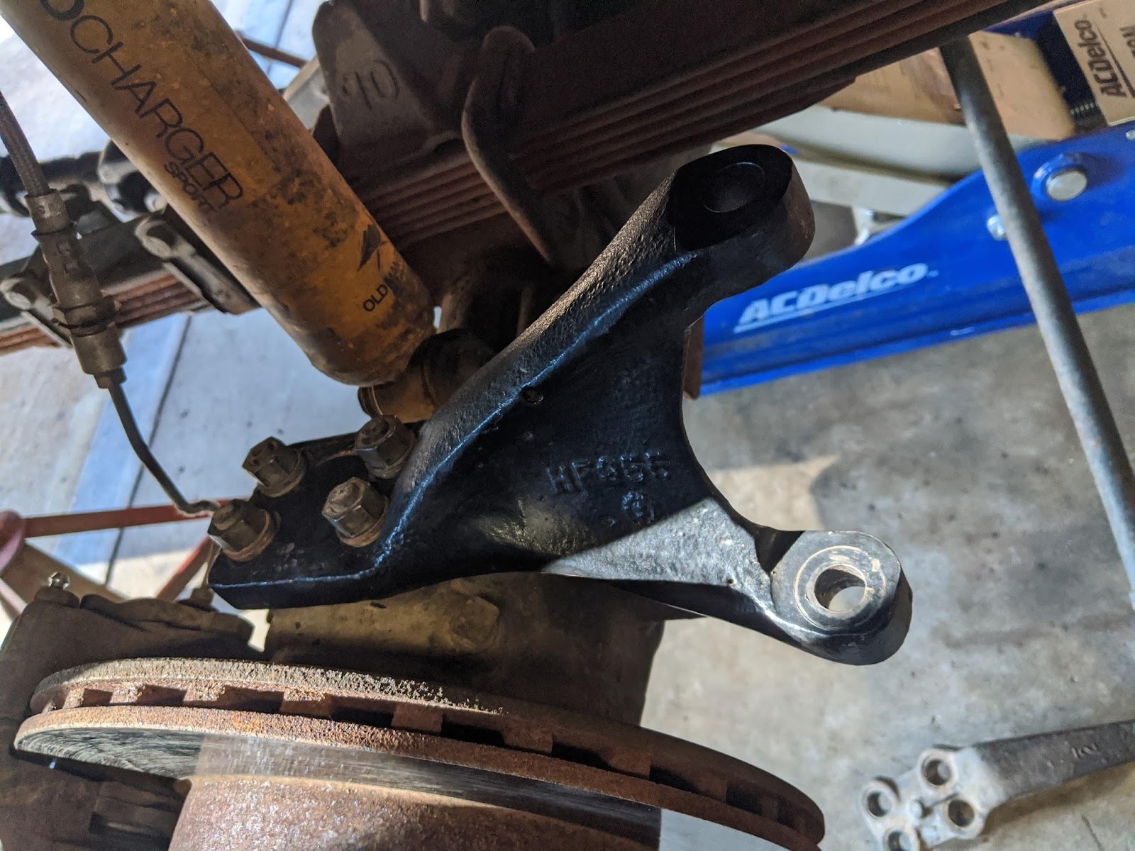

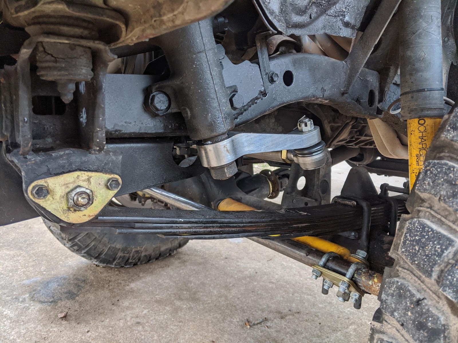

Then the Aqualu Steering Arm was installed in the top of the passenger-side knuckle and the new tie rod and drag link were installed so that the IFS Steering Box mounting location could be mocked up.
v7PZL1-v9a7xQKvTXqv9AULom-DNTRLV7q6bjeNLpaY4bR8VFM76dubFP4WLpjC7w_7I6GBbvQXtfPc8ebfVcmFuEbu2d80CN0NgaycUiVpixnzRQnr6X-KnxlkdsI4Jj1DQYZmV

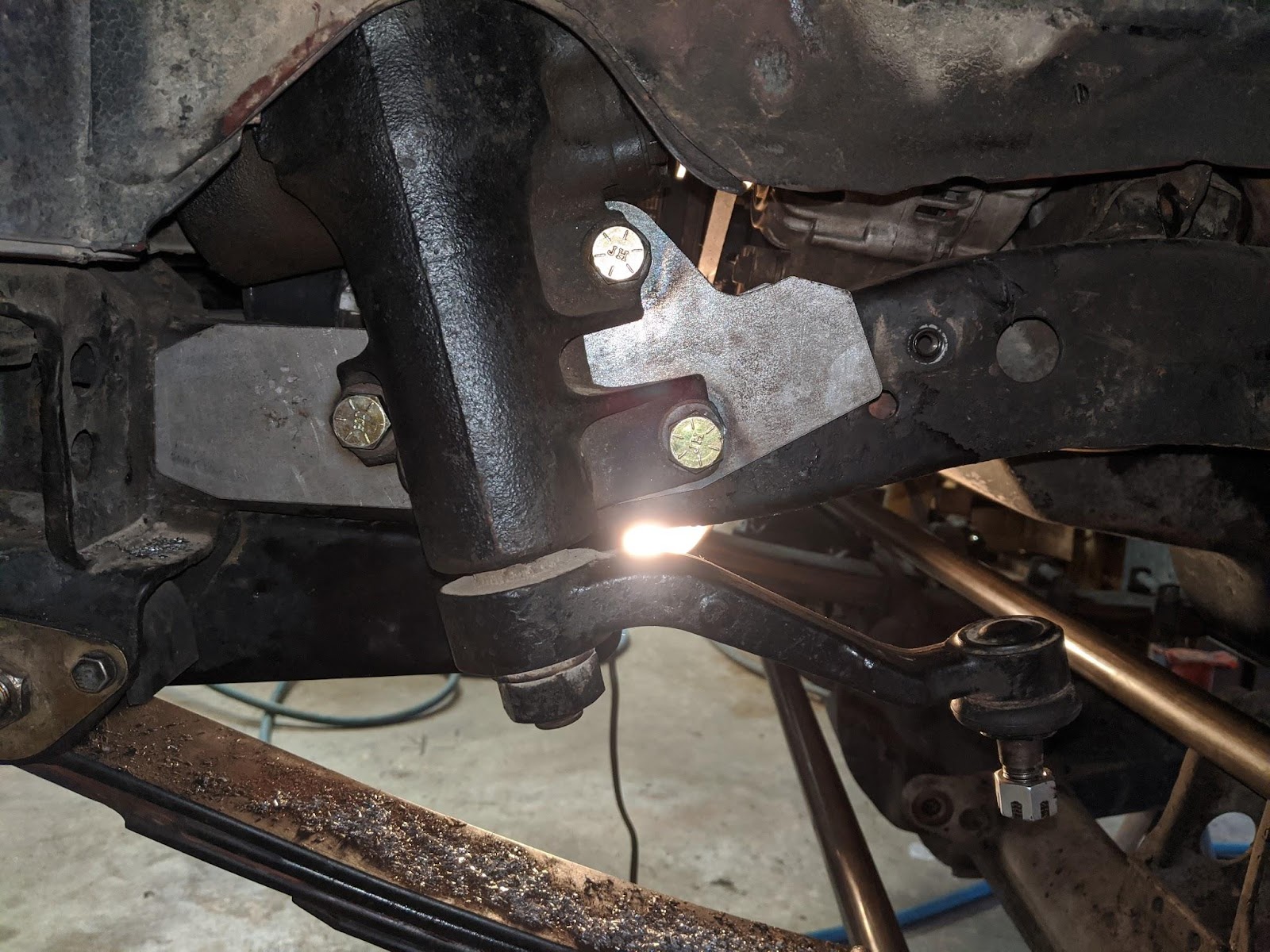

Then we started mocking up the IFS Steering box location. NOTE - you typically want this mounted as far forward and as high as possible while still allowing enough clearance for the pitman arm. Our original intention was to be able to use the factory pitman arm (for easier/cheaper parts availability) but we were restricted by both the lower ARB Bumper mount and the sheet metal behind the factory steering box and this ended up not working out as you'll see a little later.

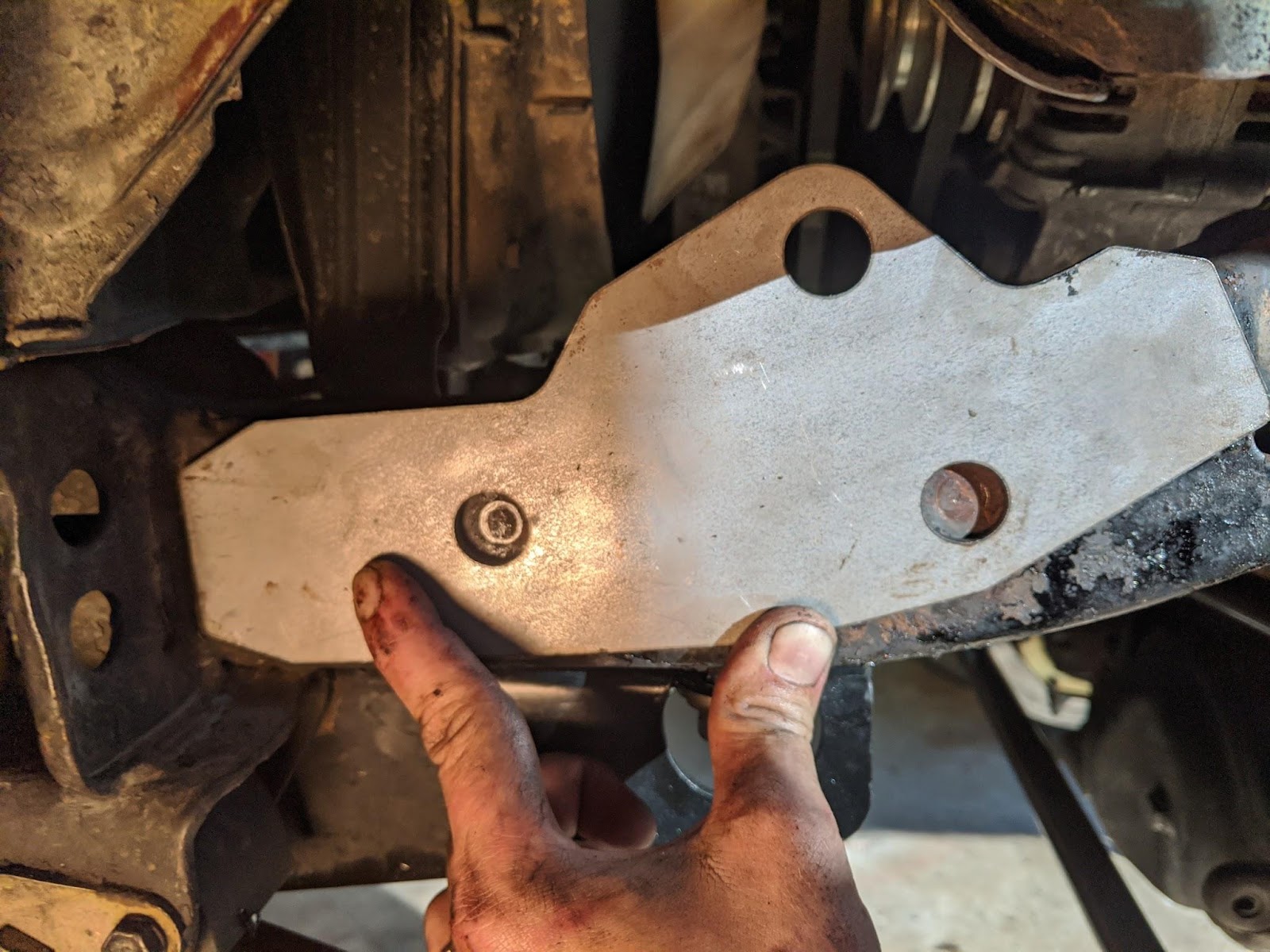

Here we're using the backing plate from the IFS Steering Box mounting kit to stencil the ¾” holes that would need to be drilled in the frame:
ZKmoFlZz4zeHbdAjqMpk5YRQfqKhnD-VeMoXgITWA8ufN-41daC3gV8eJmG-6DXR3MCYr00HEO5pGadtAXAjEADRVX97DJXTfSQOBqTmhZ5YGi7d9Q3WVUrHoh_KGdqKFa8XnBKE

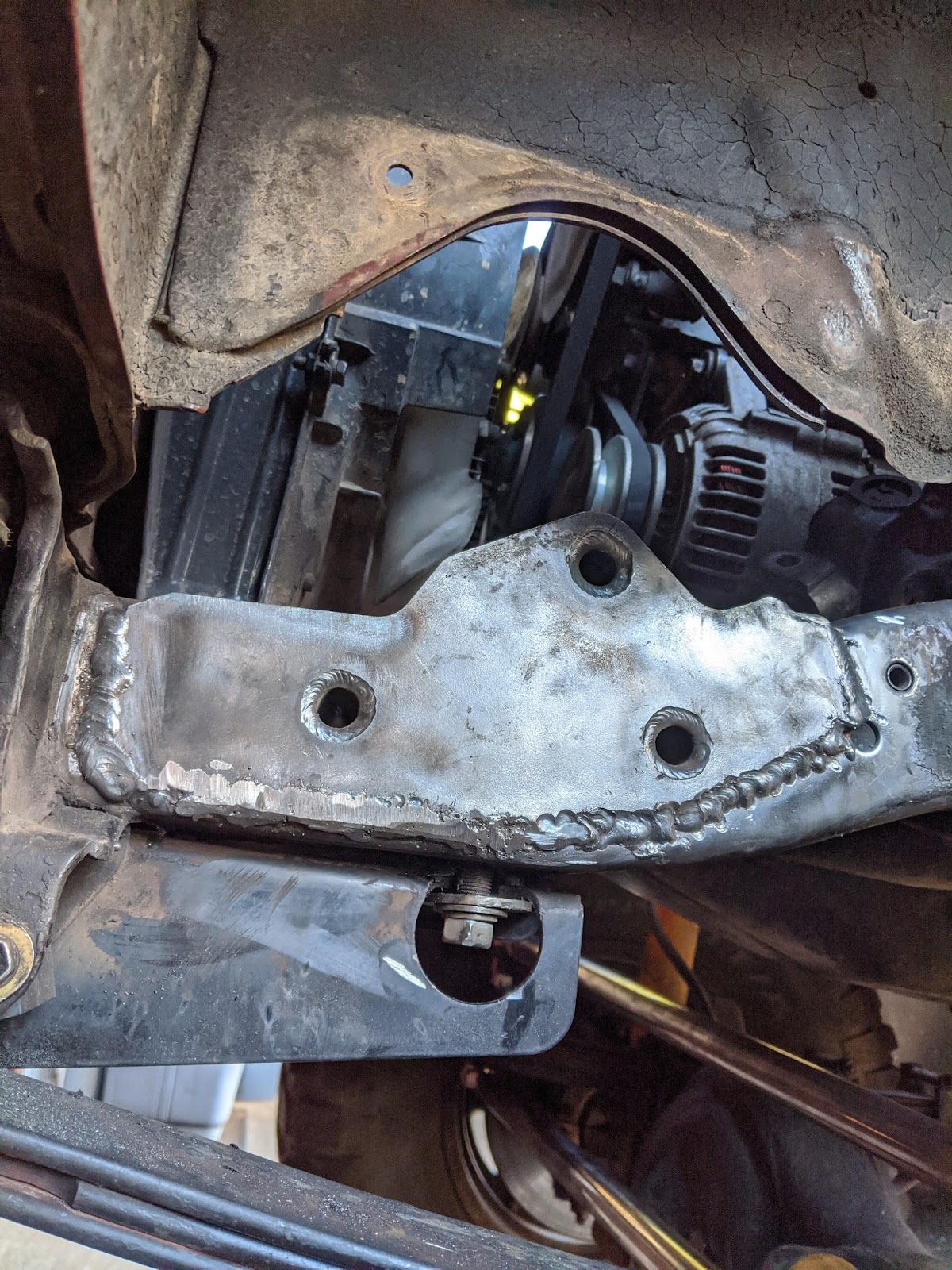

Once the holes were drilled, we test-fit the IFS steering box and draglink to double check alignment and clearances before welding the mounting kit in place.

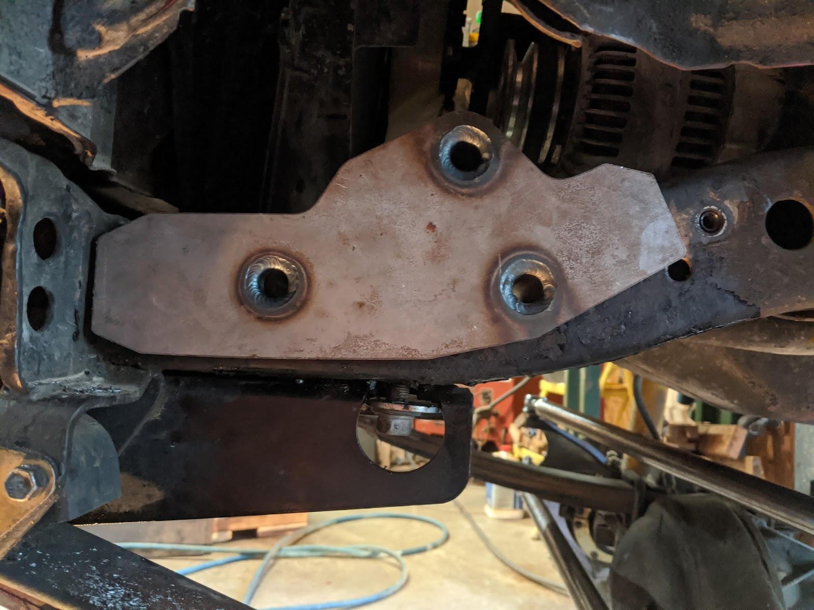

3_f5VSJxpxuRdUr5by1FHbsmKVc5NEI3sxIqHy8bPkBPOjwExIrlpKVSlzf_C0PMBk-EsIaClLmQI9gvo44j5xeHlIUXJfs-UBAcW8RPehz9W1pvRK4M748bBldf5ggyZB2ye4tp
Then we removed everything, cleaned up the frame, and welded the IFS mounting kit in
cL-7aGsviDBfiOMrBCZRQfE-RKfwJymJNAOWP_xbfJNaA7D6-99GNZ9MxKK3NgSVrzQlCbbgsBmWreBGs4V6-pTeyhiNsG-3abkvj1PvJX0nSX9Yj3dJt93xVIWFAVutuMjVDaqt
oYBEG4hFt7IJDdo4MEuAgPH4h8yjUymVpsPBWAZbwiXQYOzpo12LcFURxmS1wAXzZGHUCLMQglKXS40Pm-ittpPZs8d3rNAmyKnJhplIsTOn2GpIBgyuEaYQqJa5yHFzS8WzZ4CW

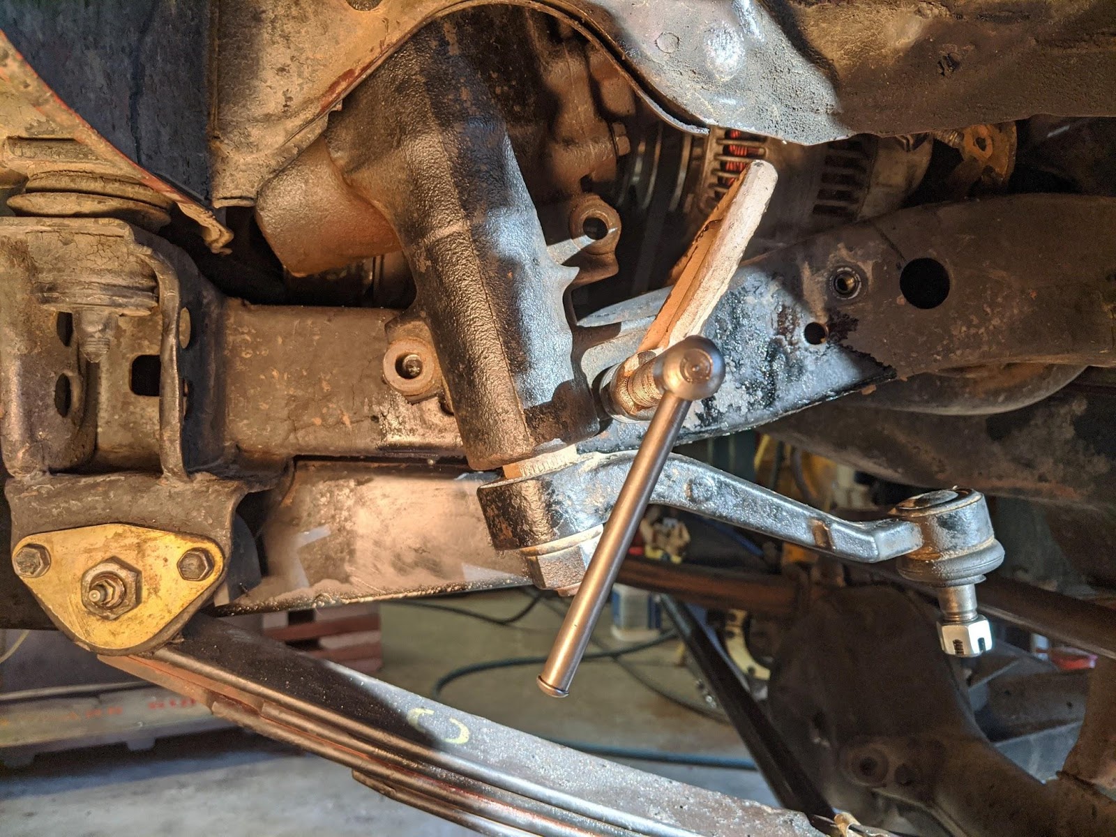

After a trail-test we found that the castle nut on the factory pitman arm made contact with the driver’s side leaf spring on full stuff. So we ended up installing the Sky Offroad ¾” less drop pitman arm and now there’s plenty of clearance even at full stuff.

Overall this was an excellent upgrade, and one I'd highly recommend! It’s been amazing the difference it has made in the ride and suspension - and made it apparent that the factory torsion bar and draglink were really limiting the travel and effectiveness of the OME suspension both on and off-road before.
