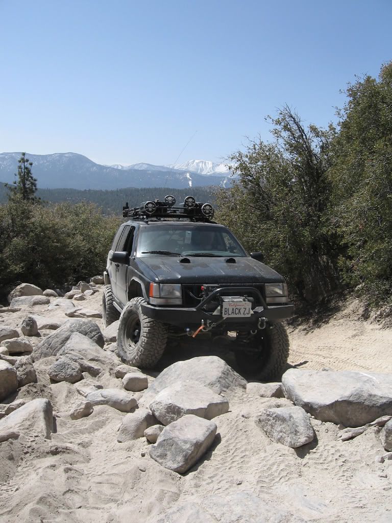

The best single piece of advice is to know what you want out of your vehicle. I built my ZJ to recreate in the local mountains and deserts and it has worked out great.
You can put up to 2" spacer pucks on all 4 springs for an inexpensive lift.
You can swap the front springs to the rear and buy new 3-1/2" front springs and 4 shocks for a relatively inexpensive lift. The F>R lift should clear 31" tires. You can use 1" or 2" pucks as needed to lift or level. IMHO 4-1/2" is about as high as you want to go on short arms in a ZJ.
Although the 249 transfer case is an excellent AWD tc for pavement it is the least desirable tc off pavement. If the viscous coupler goes bad it is an expensive repair.
Aluminum 44 in the rear only has one locker option. (Aussie) For mild offroading the 44A is not a problem. Beyond mild it needs to be trussed.
CV driveshafts and CV axles cannot be fixed in the field. Ujoint driveshafts and axles are an easy swap.
Unibodies need support beyond mild offorading.
