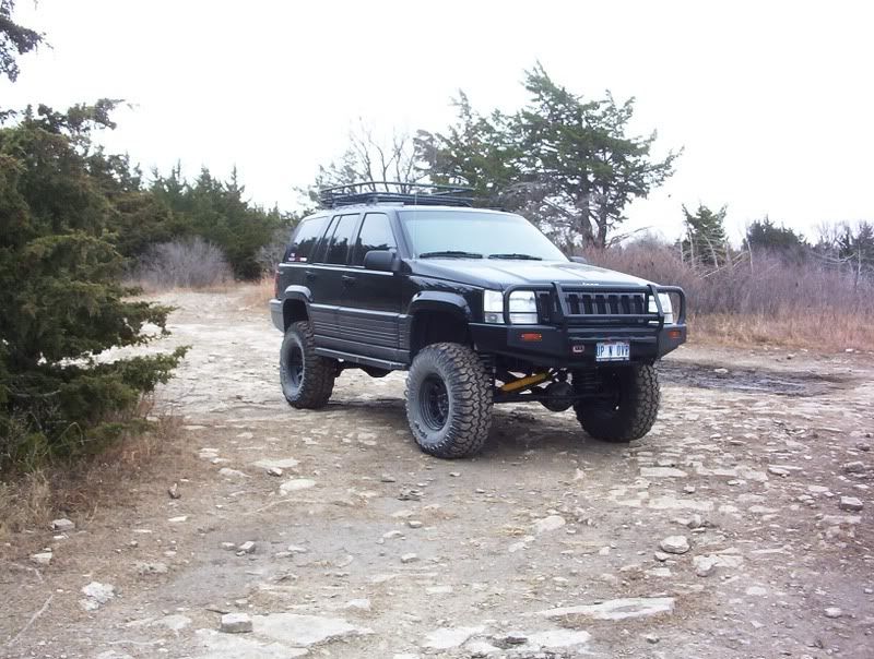

1st '94 ZJ with 2" lift, 5.2L and some 31's. This went to a friend of mine, and he still has it.

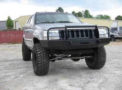

Here is a ZJ I owned for about 1 year, the 5.9L came along and I traded this one for the 5.9L, I kept most of the parts from the '96 to put on the 5.9L.;
'96, 6"es of lift, 35's, lockers front and rear (had the aussie locker in the Dana44HD which they have since ceased production), ARB bumper, etc.
