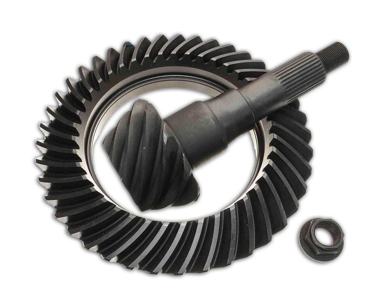

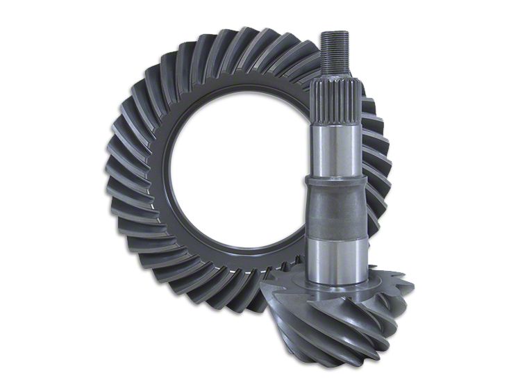

I don't know the final goals for jumping to 4.10s or 4.30s, but I think either is probably a good call.
In my own case I would probably wait until I made the jump to a bigger tire and then figure out how much gear I would want. Worse case scenario you realize you don't need that much, though the cost will be roughly the same.

Correct me if I'm wrong but isn't it 8.8 front and 9.75 rear? The link gears would be for rear only because they're not reverse cut?
edit: I'm looking at S3M's site and they only have full sets for 4.11 to 4.56 in that range... so maybe the 4.30 is for 2WD?

Depends on the truck. Some have an 8.8 rear and some have the 9.75. All have the same 8.8 up front.
After 2015 they came out with the "Super 8.8" rear end.
